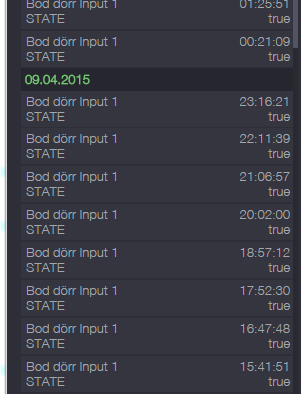

The In1 sends status to zipato (screenshot), but newer change status if the door is open or closed. I have tried set the In1 to Bi-stable and Normal Closed.
I have no idea how butt now it started working!!?
