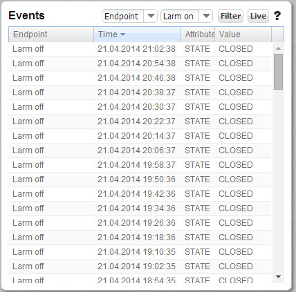

I manages 2 zipabox using 4 Fibaro Universal Sensor FGBS321.

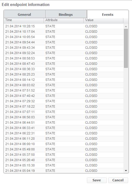

I found a problem in the FGBS321 events log : Even when the state does not change, it is written in the event log every 11 minutes.
So, the events log are unnecessarily overloaded and become unreadable.
Can you fix the problem so that only the state changes appear in the event logs?

I have same problem, but it's 8 min between the notes in the event log. No physical change in input state.

Hello Jerome
The issue in
event log you noticed is already know and it is being taken care of. The problem
is that in the event log, you should not have same event more than once in the
same hour. This is a bug which will be resolved with a new firmware release. New
firmware release should be done and published in 2-3 weeks, but as this one will
have a lot of updates I can't give you exact date as there are a lot of testing
which must be done before it is released.

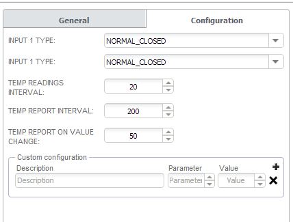

Temperature reports occur every 10 minutes and no parameters affect it. Someone decided this
