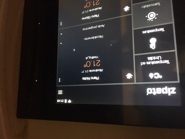

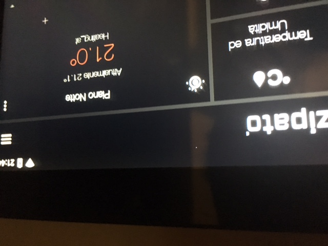

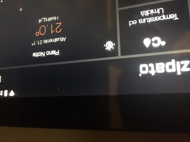

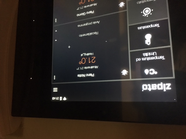

Hi, a new bad hardware behavior... please give a look at the attached pictures. The pixels in the upper band (1/2cm) of the touch panel flash continuously and randomly during any time of the day in any kind of conditions and any screen. Random pixels position into the band and random number of simultaneous pixels flashing at the same time.
Updated, upgraded, rebooted, rolled back to the last release and again to the last beta with no progress. It's about a month that it is this way; not sure but probably in coincidence with a firmware upgrade. But since that time it did not stop anymore...
Please give feedback, suggestion, share opinion or the way to address if you know...

This happens when the automatic brightness is placed, when you remove it disappear.
I've done this in several zip lines and they all have that same problem.
where can I disable automatic brightness? sorry I'm not an expert.

thank you, i didn't know about this feature.
flashing pixels stopped!!
