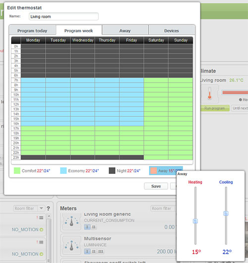

To change "Away" mode temperatures please see attached image. Also note that you need to press "Save" button after making any changes in "Thermostat editor".
Thanks for your attached image, but we don't have the same.
I have no choise of away setup like you can see on my attached image.(Capture5)
Of course, i press "Save" after changes.
Why there is no changes on my AC in auto mode (Confort to Eco) ?

CrhisDalo, can you contact us on support@zipato.com? We would need to login to your box to check out this matter with AWAY settings (it is strange as we can't get it here)?
Now you should be able to see and change "Away" mode settings.
