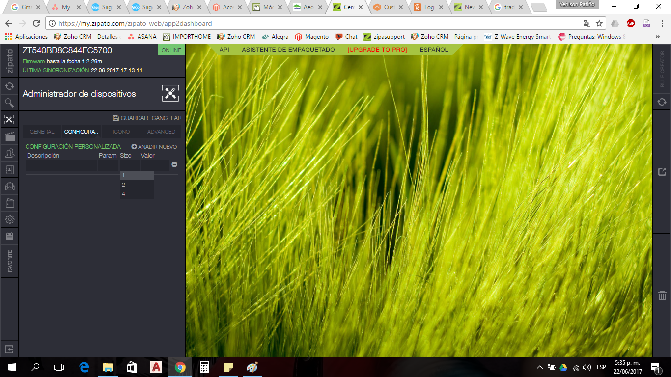

I have a garage module AEOTEC and I want to change the sound tone and turn down the volume and looking at the manual of the equipment tells me that I have to enter some parameters to do it I was looking at the device manager where the garage module is and appears for me Enter the parameters I was entering the parameters that says the manual and it does not work and I have doubts when I enter them.
In the size box appears 1,2,4 for what it serves and which one to select.
And which values should I place in the other boxes so that I can lower the volume or change the tone when I open or close it.
attached photos

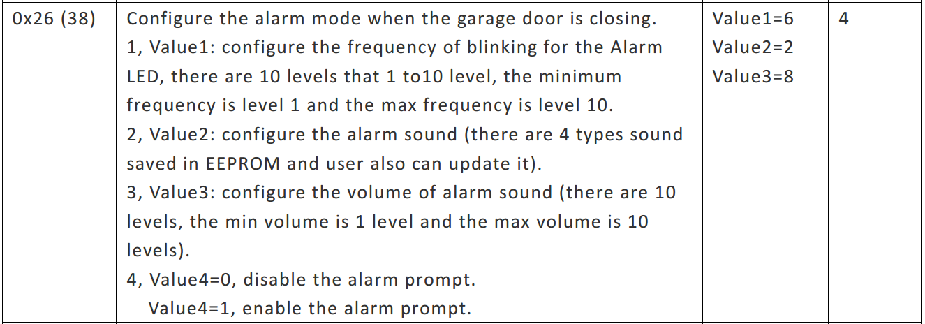

Ok I will try but I should not enter is the parameter 38 that is the one that says the table of aeotec
