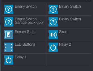

I'm trying to work with my rule creator. I have several Z wave switches and in the Device section of rule creator they all show up as "Jasco Binary Switch" all except one which has the correct label, why that one is different I'm not sure. When I go to each individual switch from the Device manager I cannot edit the Device field where "Jasco binary Switch" is displayed. Attached is a screen shot.

I can imagine that you included 3 of these without giving a name and room, and the last one with name "Garage back door". So, go to each of these switches without identification name and open up the tree to find which device in the tree has name "Binary switch". Now you need to rename that one.

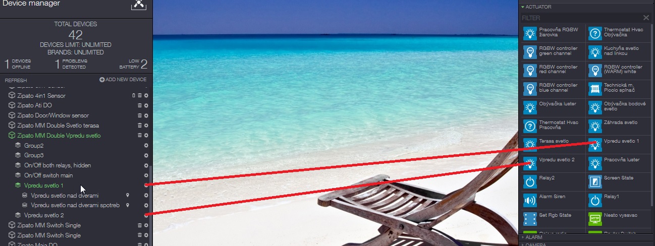

See the attached printscreen. You can see that my light "Vpredu svetlo 1" is used in the rule creator, however as you can see the device below "Vpredu svetlo nad dverami" is the one that I have on the left as a light device.

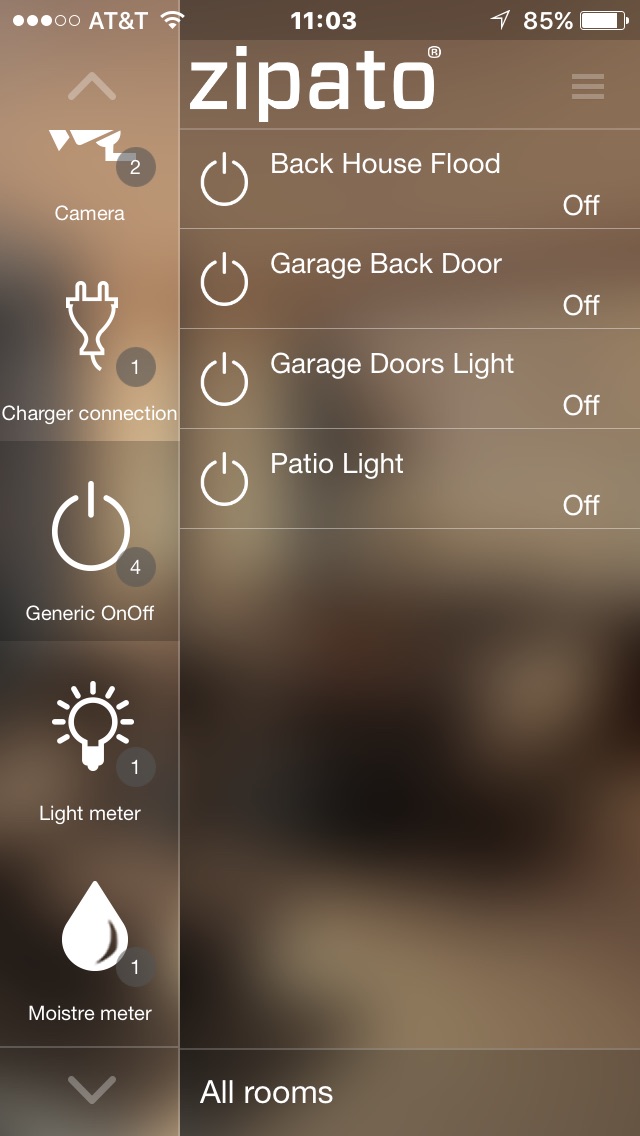

These devices have names. They are named in the device manager and also in the Zipato app. Please reference the below screenshot from the app. These names do not carry over to the rule creator.

What im saying alex is that possibly a diffefent level device is used in the rule creator and in the device manager. Hence why i attached my screenshot previously. Have a look again and youll see what im talking about.
