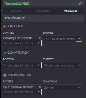

could someone please explain how to associate the target temperature from the Zipabox virtual thermostat with the target temperature of the Heatit device. See my picture: did I miss something?
Thank you,
Christian
Thank you,
Christian
