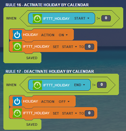

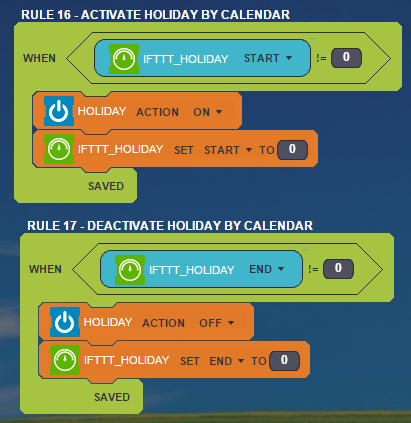

Define two rules in Control Center (you need also a virtual switch for holiday, Name = Holiday):
4.1. When virtual meter Start !=0...Holiday Action On...Start = 0 (reset)
4.2. When virtual meter End !=0...Holiday Action Off...End = 0 (reset)
That's it :-)
There is a mistake in the second rule. Again the attached screenshot with the corrected rule.
