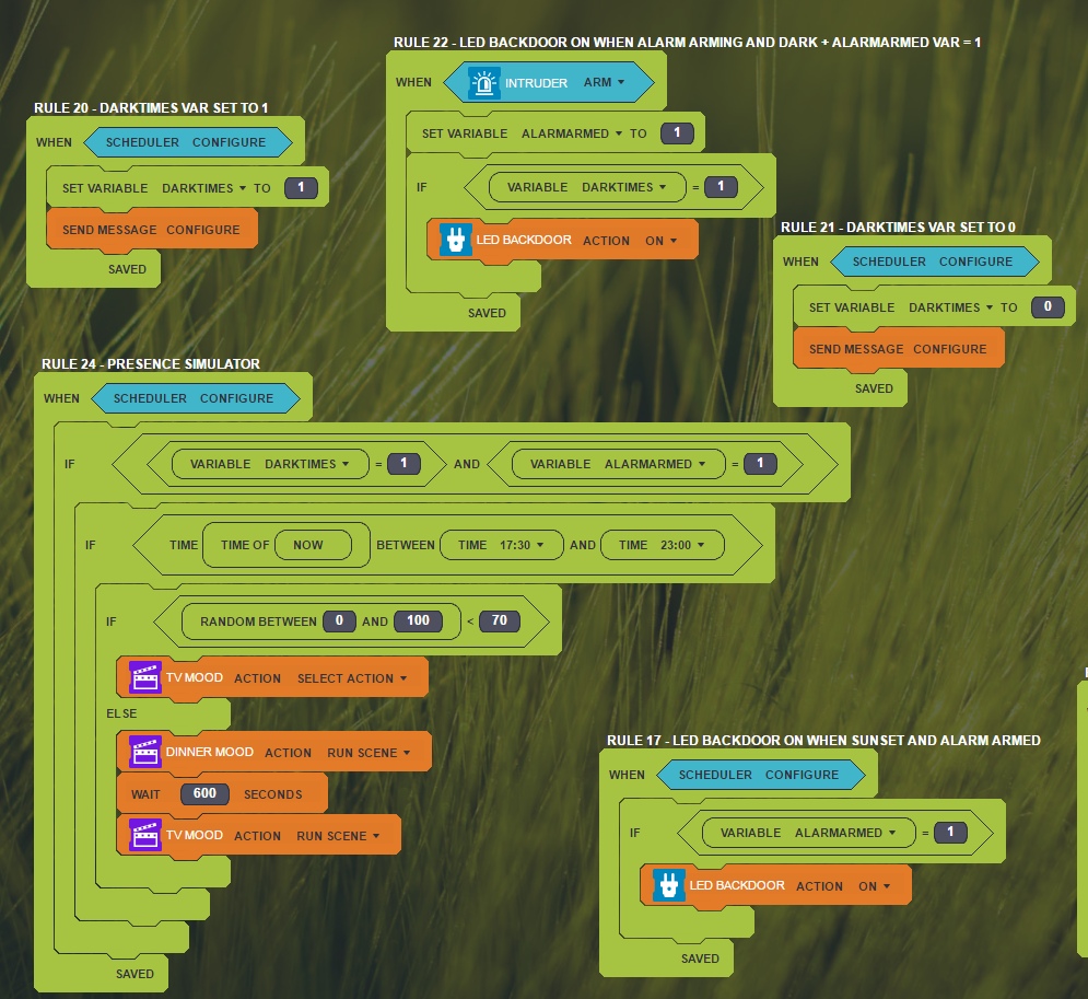

Create two variables that are set with simple rules, I called them DarkTimes and AlarmArmed. These can have the values 1 or 0, they act like a flag. (My DarkTimes is set using the sunset/sunrise scheduler). Now it becomes quite easy to test with an IF statement for all kind of rules.
I guess the reason why your rule isn't working is because the IF statement with Partition 1 is only going to work at the time of arming, not when it is already armed before.

I think the problem is that you are trying to use and event as a meter. I see you are using IF Alarm is ARM, but that only is true when you change from disarmed to armed. You need to use a meter block with an "equal to" operator and then drag the alarm so you can choose if you want ARMED HOME or ARMED AWAY. Other than that your first rule should work I think.
Stian,
