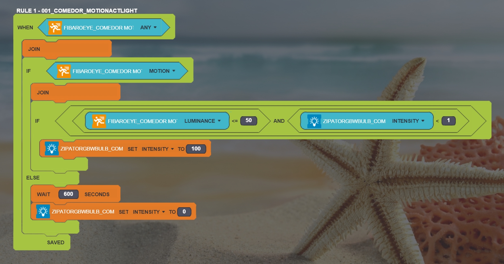

Sensor: Fibaro Motion Sensor
Actuator: Zipato RGBW Bulb
Purpose of the rule: Set RGBW bulb luminosity to 100% if the motion sensor has detected motion and the luminosity in the room is less than 50 lux, also this rule will only turn on the light if the bulb is completely off. This is so if you entered the room and then you activated an scene, lets say, you dim the light to 50% this rule wont override the luminosity set by the scene.
Nice, thanks for sharing. Great to have the lux implemented :)
No problem!!
