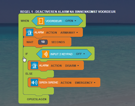

Hello , can someone help me with the following rule?
The intention is that the alarm does not sound after the door is opened when the keypad is operated within the specified time.
I have the keypad working and able to turn on and off with the alarm.
In the current situation the alarm always goes off after the specified time .
Deactiveren ala...

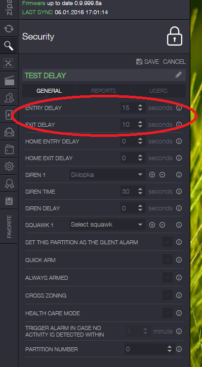

Hello Weslop,
For this function you do not need to create rule. This feature is implemented in Alarm partition, search for "Entry delay" under alarm partition settings and set it to desired time length, after that you only need to set desired security zone to be "This zone is the entry zone"
Hello Weslop,

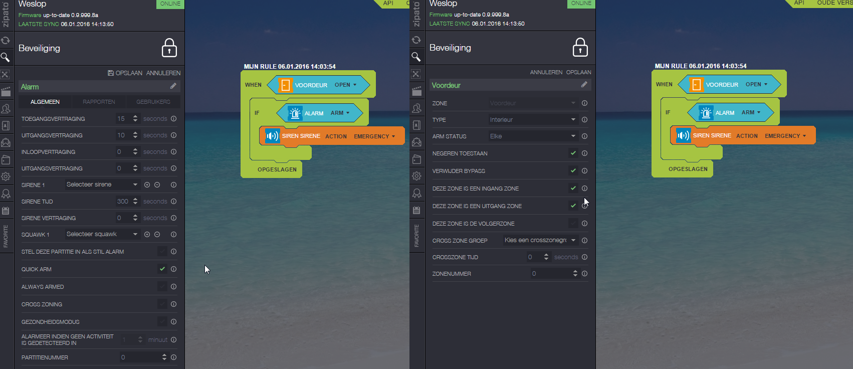

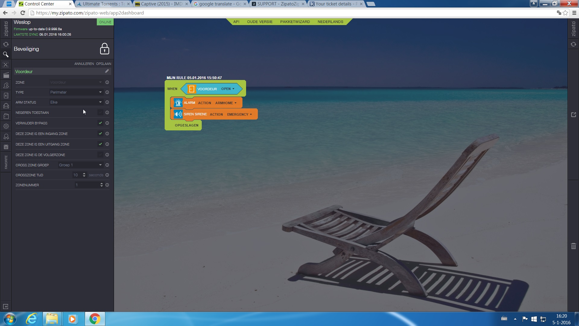

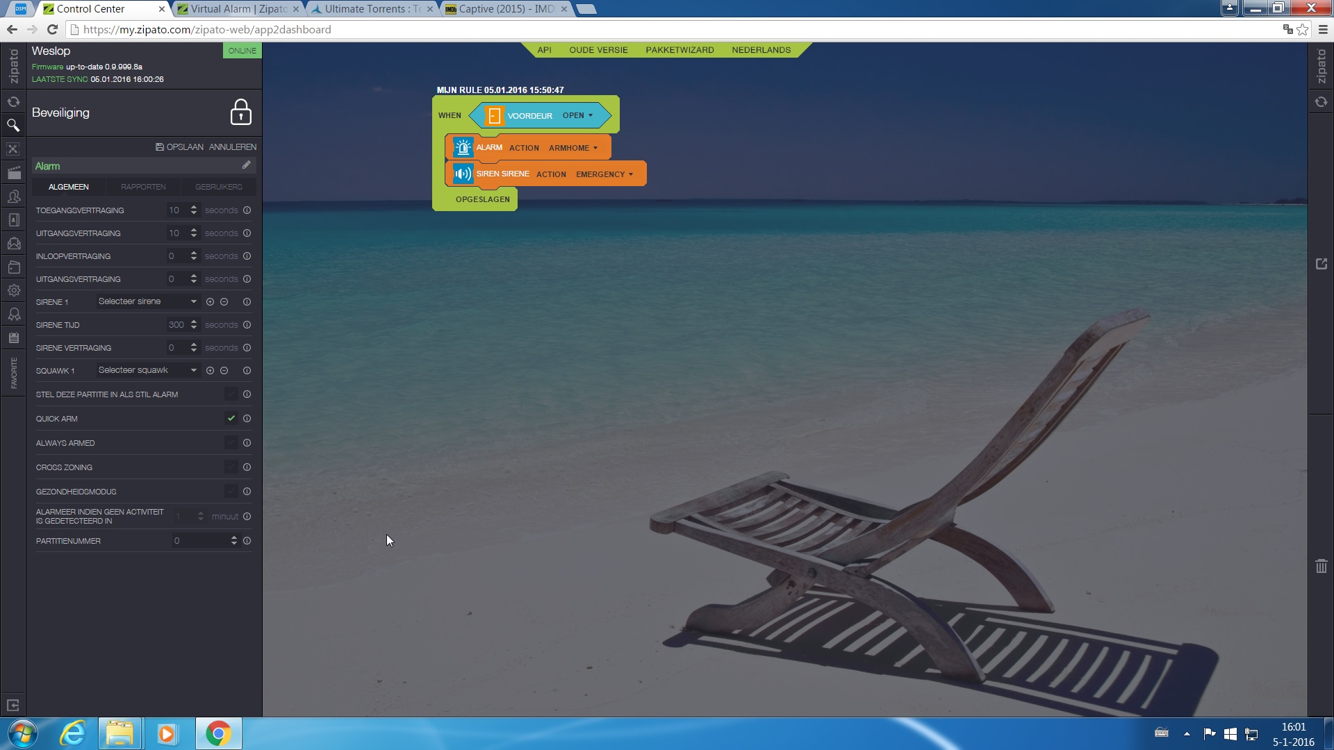

Thanks for the reply.
I've first tried , but have not gotten working
see screenshots
see screenshots
the data set did not seem to be active ??
see screenshots
see screenshots

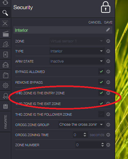

Hello Weslop,
I have attached printscreens of the Partition and Zone configuration my colleague Antonio was referring to when using Delay.
Hello Weslop,
I have followed all the steps.
old alarm deleted, new created in virtual divices . all settings set so as directed. But without any success.
What am I missing here ????
