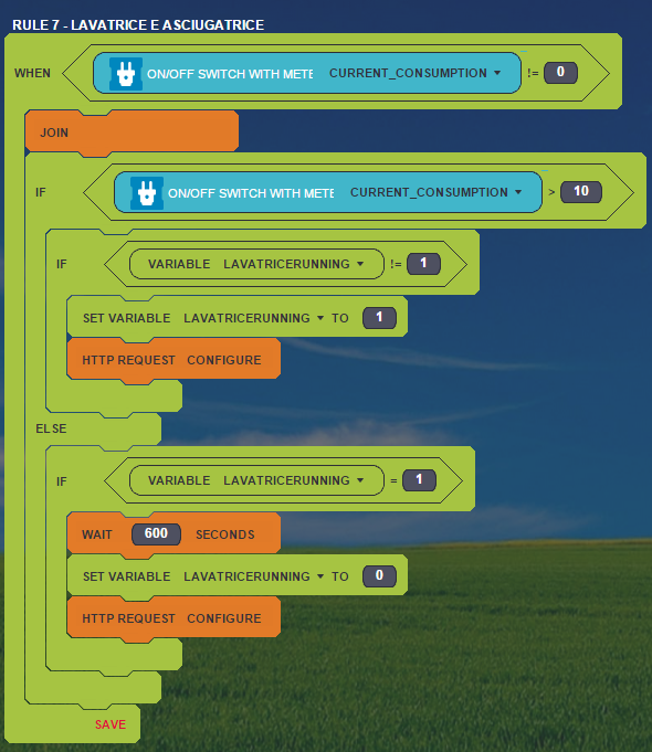

I'll try to describe what I'm after.
A device usually uses say 3 to 5 watts. I'd like to trigger a rule when the usage hits 100 watts. And get notified. So far I have figured it out. What I'd also like is to get notified when the usage is back to 3 to 5 watts.
What would such a rule look like?

Try to have a look at the attached image.
Files: rule.png
I started making something like this. But now you saved me a lot of time. I'll replicate your rule shortly.
Thanks a lot Carlo!

Hi Carlo, thanks for your screenshot in the other thread, similar to this problem.
I was curious to see if Institutionalized's rule could do without the
WHEN current_consumption != 1
clause (like the rule you suggested). In my mind it should work with just
WHEN current_consumption > 100
or whatever value.
I never tried to use just "WHEN current_consumption > 10".
I found using "WHEN current_consumption != 0" more useful because it allow me to have a single rule that handle variation above or below a specific threshold (in my example 10w).
In the hipotesis that works using "WHEN current_consumption > 100" your rule will be triggered for every change above that value but you don't have a way to receive a notification when curren_consumption will fall under that value without using a second rule with "WHEN current_consumption < 100".

My rule was fired when the wattage was over 100 and a variable was set to 0. The rule then sent me a push message. And then set the variable to 1.
Another rule then reset the variable to 0 once every hour. For me not to get spammed by the first rule.
Maybe not the most elegant way.
