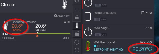

I have an issue with my Horstmann HRT4-ZW wall thermostat since a few days (it worked fine since 3 months before...)
The value "Setpoint_heating" is always 20.20°C even if the setting of my climate is 20.30°C (see snapshot)
Am I the only one who has this issue ?

I've checked what the zipabox sends to the HRT4-ZW, using the API :
The value sent by the Zipabox is : 20.2999992370605, instead of 20.3
Could you please check ?

Again, since a few days.
If I set 20.3 the "Setpoint_heating" value is always 20°C
If I set 19.8 the "Setpoint_heating" value is always 19°C
Am I alone to have this issue ?

Dear Christophe,
Our team are working on resolving this issue.
We will let you know when it's done.
