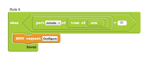

ok good to know. I'm considering the "wait" option in infinite loop otherwise.
Anyway it makes sense to me only when we'll be able to have attributes in http request.
