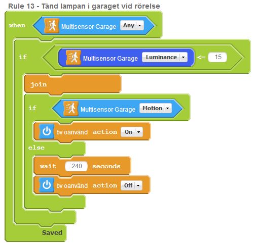

This rule is working fine for me,

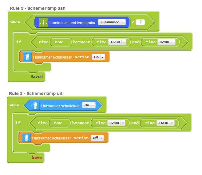

I try this one time more.
turning on the light is working. but turning it off is not working.
I made a screenshot of both rules. turning on the light, and turning off the light.
The problem is when i want to turn it of, it is not if the light is on.
My light gives a state on or off when it is switched. but inbetween not.
so if i start the rule with:
when light is on. how can the rule check if the light is really on or off?
so the main question, is there an option that a rules checks the state of the ligth/rollerblind etc. when the rule is starting.
Files: rule.png
So if the time is between 02.00 and 16:30 and the lamp is on you want to turn it off?
U can use the scheduler for this and check every x min. but don't make to many rules with this (CPU load).
but how does it check it? because my Everspring AN158 is only sending its state when the light is switching. so if the light is turned on by the first rule. it sends the state "ON' one time. how does the second rule know the light is on? because the state will not change.

that works like a charm. but i still don't understand why it is working with a scheduler. and not working without. because when I change:
when -> scheduler (configured)
to:
when -> light is on.
the when light is on. is not working. but if I "check" it with the scheduler it does check the state of the light.
You need a trigger to trigger/start the rule.
But the state off the light is not changing so it is not triggering the rule.
