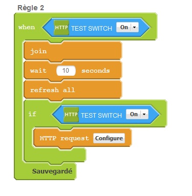

Hello
Id'like to do that :
When my virtual switch is ON
Wait 10s
If virtual switch is still ON Then do something
(Else do nothing)
How can I do that ? Can you help me ?
(join fonction seems not working in that case, or i don't understand how to use it)
Replies (4)
Your rule should look like this:
ZEmyV2lGGlh5hcXVi2iz
Great ! It seems that i could do everything that I want with your box ;)
Hello
It is not working for me
When tje 10 seconds are finished, the action is executed, even if the switch get back off within the 10 seconds.
Is it a bug or a mistake in my rule ? please have a look to the joinde file
You need to put your virtual switch in sensor puzzle and choose true (same as On).
Save and synchronize, it will work.
