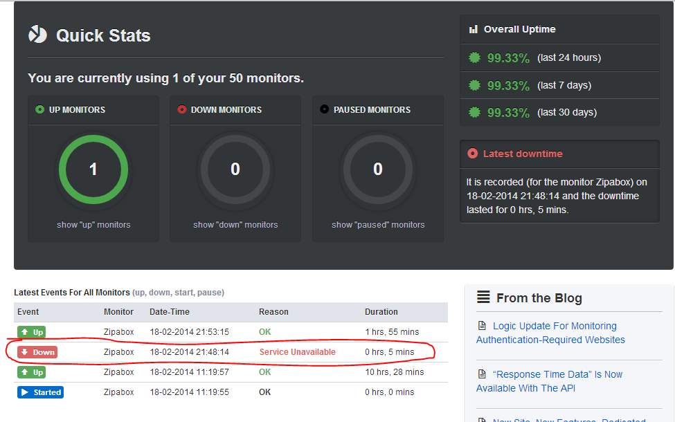

Yepp, the Zipato-servers were down for about 5 minutes at approx 21:48 swedish time tonight.
Thanks to a great tip in the thread https://community.zipato.com/responses/myzipatocom-down-_2#comment-7852 about using Uptime Robot (http://uptimerobot.com/) I got an automatic email at approx 21:48 swedish time that my.zipato.com was down (for about 5 minutes).See attached screenshot. I can very well recommend this service! :-)
