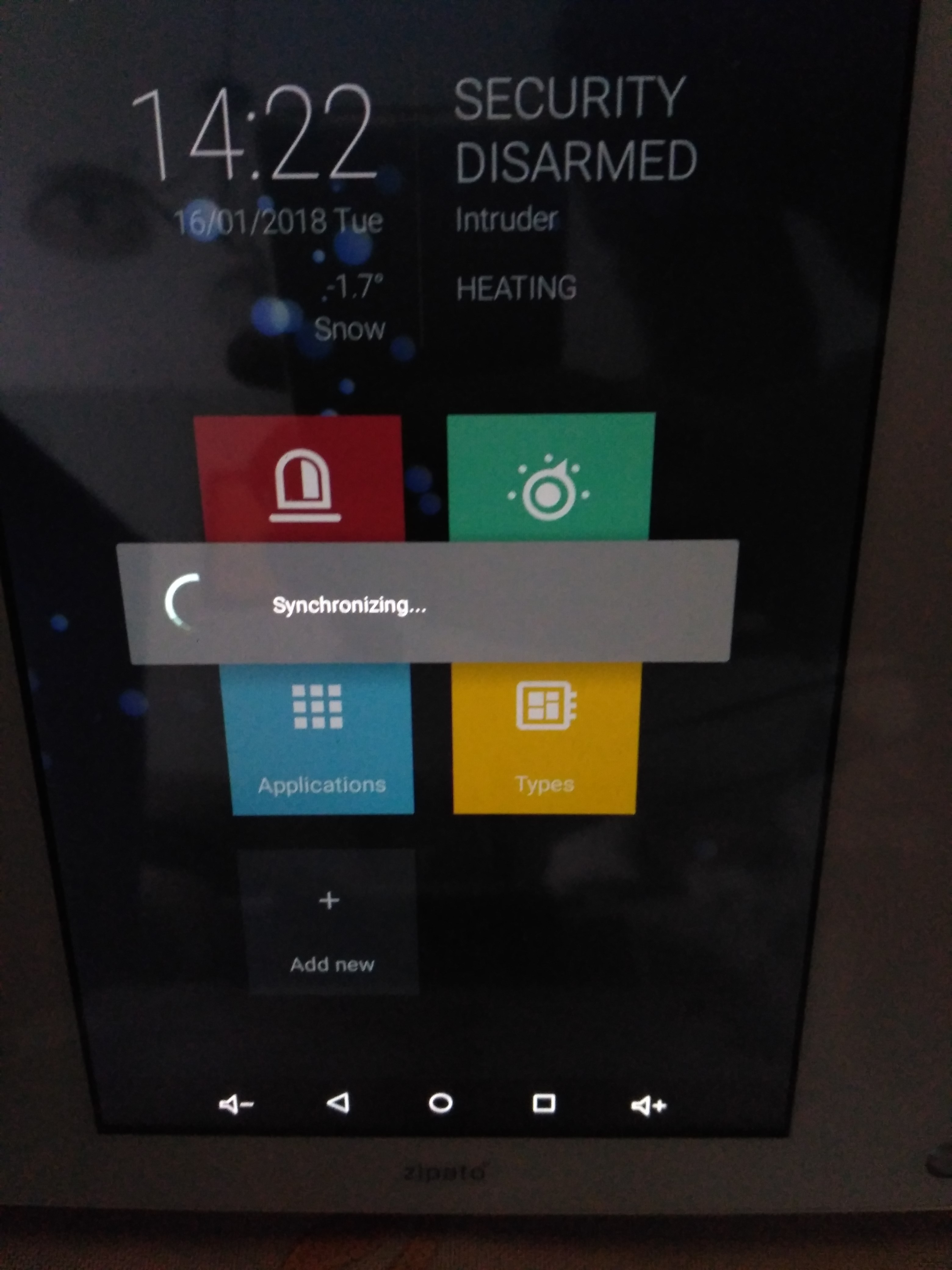

I'm facing this issue all the time, sometimes it just show up and disappear and sometimes it keeps "spinning" for days, until i reboot the Tile. Is there any solution how to prevent this?
regards
Jozef

So i have created separate wifi network for tile only(ordered eth adapter also), and problems disappeared, or they are occasional. It looks like, stability of network connection is absolutely crucial for zipato communication protocols.
