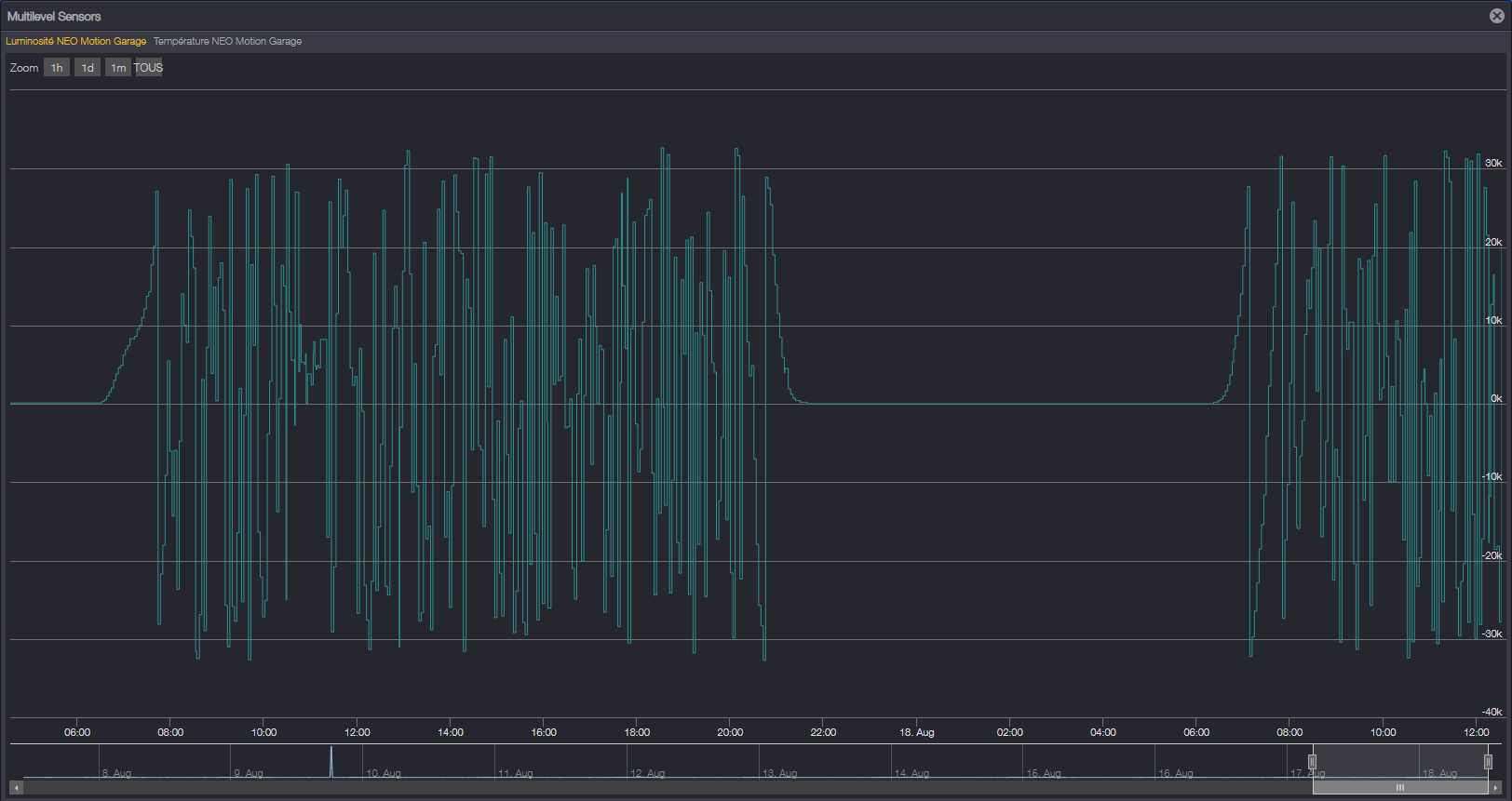

I just recently bought two as well and am still experiencing with them. Movement works reasonably ok, but the lux-sensors are not really accurate.
Even when positioned right next to eachother, "PIR1" reads 7169 lux and "PIR2" reads 4444lux... They are litterly positioned in the same light,.. So I guess it's a matter of trial and error with each individual device to determine the values depending on the light.

Readings:

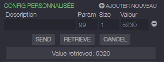

Its not a bug, its a bad device configuration.
Trough custom configuration options, just set parameter 99 to 5230 and it will work.
