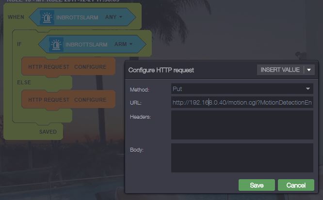

I try to activate motion detection in an IP-camera when the alarm i armed.
I found out that this URL works fine:
192.168.X.X/motion.cgi?MotionDetectionEnable=1&ConfigReboot=No&user=XXXXX&pwd=XXXXX
When I write it in the webbrowser and press enter it works fine. I can turn motion detection on and off.
I tried to use it with a HTTP Request command but it wont work.
I guess the problem is that I don't know how to send http-request from Zipatile.
Can someone help me, please. Explain how to use it or give an example.
Best Answer
I managed to solve it now, by using GET and this url: http://admin:password@192.168.1.X/motion.cgi?MotionDetectionEnable=1&ConfigReboot=No
Replies (3)
This is how the rule works.
I figured out the problem but not how to solve it.
After I restarted the computer the URL did not work if I did not enter the username and password.
After I enter the user name and password this URL work
http://192.168.X.XX/motion.cgi?MotionDetectionEnable=0&ConfigReboot=No
Obviesly I don't get access to the camera.
How am I supposed to write the url to get the auktorisation?

Did you try "Post" rather than "Put"? Just a thought.
I did try both.

I have Dlink camera and this url works fine in browser. But wont work with Zipato.
http://192.168.1.X/motion.cgi?MotionDetectionEnable=1&ConfigReboot=No&user=admin&pwd=password
Ja Mattias det fungerar.
It works
The trouble was that, the http command that needed separat login did only work with internet explorer. For that reason I did all tests with explorer.
I tried you code in chrome. It worked fine without separat login. And it works with zipatile and my dlink.
Thank you very much.
Solution is this format
It works with chrome and Zipato http command but not with internet explorer.
