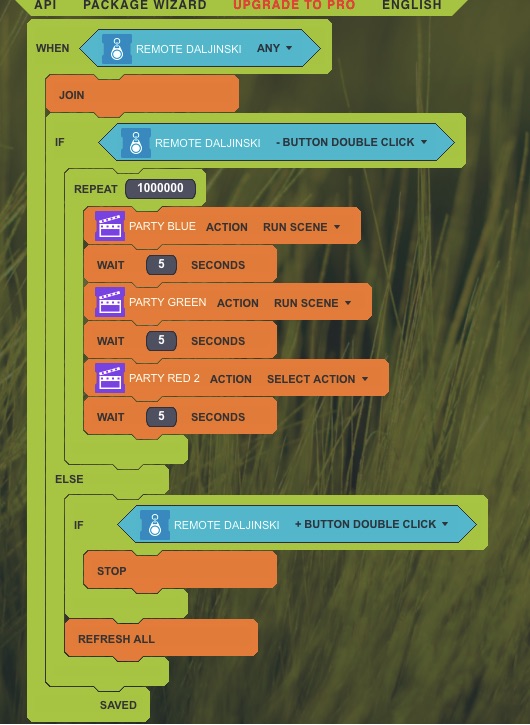

Only way i know how to repeat 20 times is to set a variable and change/up it (20 times).
If you still need to have party scene this one I made is not so bad. Change repeat time how much you need but it is not so important when you can stop it with another switch. If you don't have remote use virtual switches.
