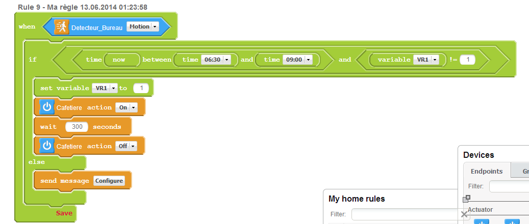

I would like to create a rule for an action is triggered 1 times per day between 6:30 AM and 9:00 ET after two hours action passes off.
You will find below a copy of the rule screen
https://drive.google.com/file/d/0B8qiKuT460y_Z2VrNmJkYjI2b00/edit?usp=sharing
Es anyone have an idea?

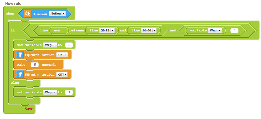

Looks fine.
But make it like this:
When Motion
If between ... and var=1
Set var to 2
Then a new rule that runs at 06.15 AM
When scheduler
Set var to 1
Or use the else for this.
Thank you for your quick response
I prefer to use solution 1 as the proposed instead of solution 2. Using the scheduler I do not like too much because too perfectible solution.
However I did not really understand how to use VAR 1 and 2.
Do you mean like this :
https://drive.google.com/file/d/0B8qiKuT460y_S2tNZkVFVUJmQ2s/edit?usp=sharing
Try this..
vBmesyBXH2UxmDmppIEt
Maybe you should also put a between time in the else.
