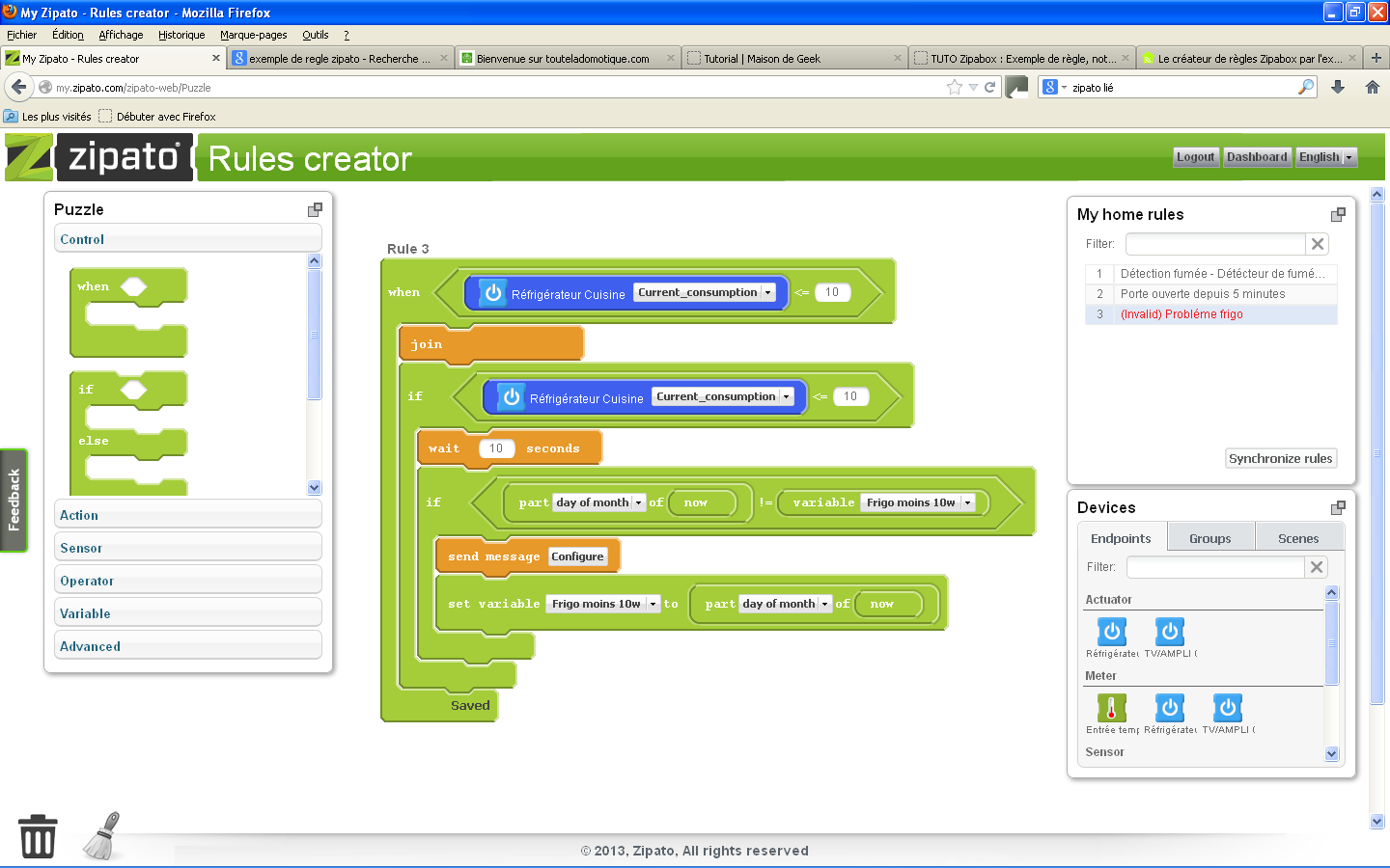

How to get a Working rule // power consumption is less than 10W
I want to make the following rule: if power consumption is less
than 10W for x seconds, then send me an email, if not already done
today.With the rule I made, it is not working (invalid)
thx
Try:
When consommation frigo <10
If part of month (I would recommend to use par of day) of now != frigo moins 10w
send message
set variable frigo moins 10w to part of month/day of year of now
Try:
send message
