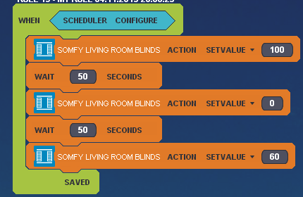

I've found a laborious but seemingly effective way to guarantee that the blinds always end up in the same spot for any given value:
- Set the blinds to 100
- Set the blinds to 0
- Set the blinds to the value you want
I insert a waiting time of 50 seconds (an arbitrary number) between each step to avoid the blinds getting overloaded by too many commands in quick succession. I don't know whether it's strictly necessary. I tried just setting the blinds to 0, and then the value, but that doesn't work either. It seems you need the 2 previous steps to guarantee that the Zipabox's assumed position and the blinds' real position are synchronised.
See attachment.

The problem is that, since, as you say, the Zipabox has no way to interrogate the blinds about their position, its stored value may be unreliable. I have a remote control which I use to operate the blinds and obviously the Zipabox cannot know anything about it. Also, although the method I've outlined works in the sense that you can get a consistent position for a given value, I've not found a way to make the values match the expected position (i.e., 33% doesn't close the blinds by one third, instead it might close them by half). Instead, I have to find out the value that I need for the required position by trial and error. This means that, even if the Zipabox has the last position stored correctly, it won't be able to adjust correctly from there to a new position. You always have to reset to 0 to get a reliable result.
I must say, though, fully opening and closing I've never found to be a problem. That's the one thing that it has always done reliably, and I've never used the offset values.
I don't fully close my living room blinds because I don't want to leave the cats in the dark :-) Hence my problem.
