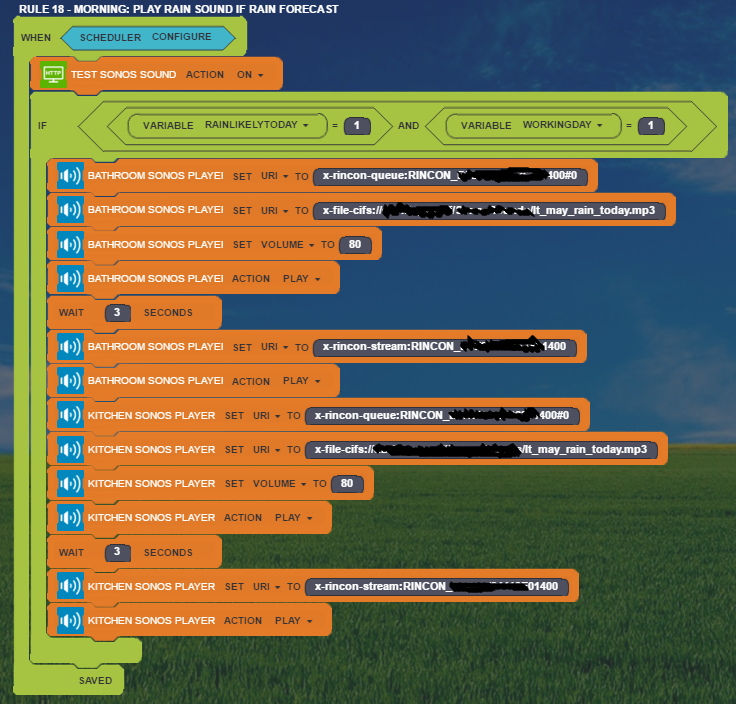

Some have said that it's impossible to play a sound on the Sonos from the local network. Not true - you just need to use the correct (obscure) syntax.
The prefix needs to be x-file-cifs:, and the slashes should be forward slashes, Unix-style. The rest is just the name of the computer, shared folder, and file name, e.g.:
x-file-cifs://mycomputer/SharedSounds/raintoday.mp3
However before that I think you need to set the URI to x-rincon-queue: and send the RINCON of the player itself (the one from which you want the sound to play). I'm pretty sure that it doesn't work unless you do this first step.

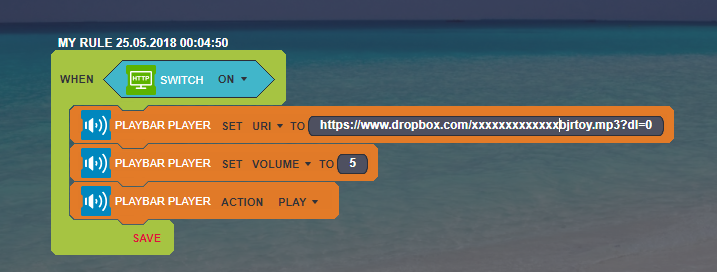

I have a Android set-top box for TV. I installed a little webserver on that box. An external SD card is my data provider. I have access with:
http://192.168.x.x:port/sound.mp3
first as allways the IP adress of the webserver
port is the choosen port (i.e. 8080)
and the file you want to play.
works

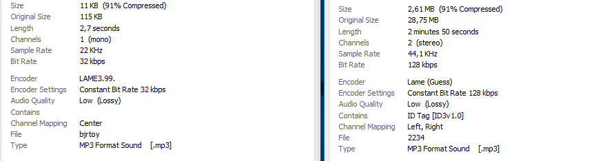

The file must be a mp3. This website converts text to mp3. http://www.readthewords.com/Try.aspx
