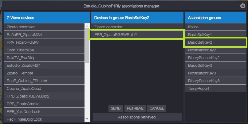

I have a qubino relay which had a switch wired to Input2, I had the Basic set association of the Qubino relay to trigger a Zipato RGBW which I now moved it to another area. How can I delete the existing association for a group??

Right click on the device to get the menu for removing.
