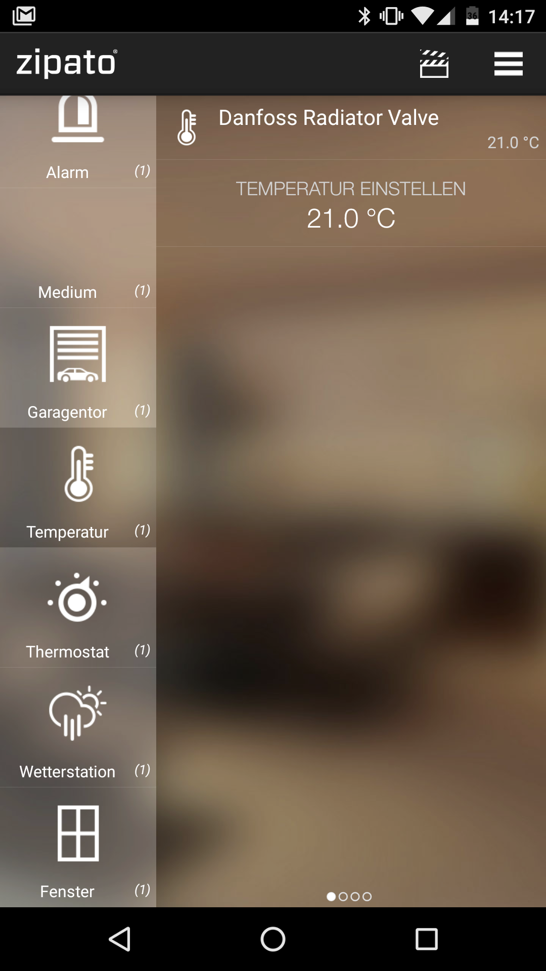

I try to set a new temperature on my Danfoss raditor valve, but I can't do any chances in Android App.
Also I didn't find any posibility in Control Center.
Can anyone help me, please?

This is the temperature device. It cannot be changed. What you need is to use the existing virtual thermostat and set up the desired temperatures there. Than you need to add a thermometer that measures the reference temperature in the room (i guess not the danfoss valve as it is not designed to measure reference temperature, you need a room temperature sensor) and the danfoss valse as the output. Then it will work.
