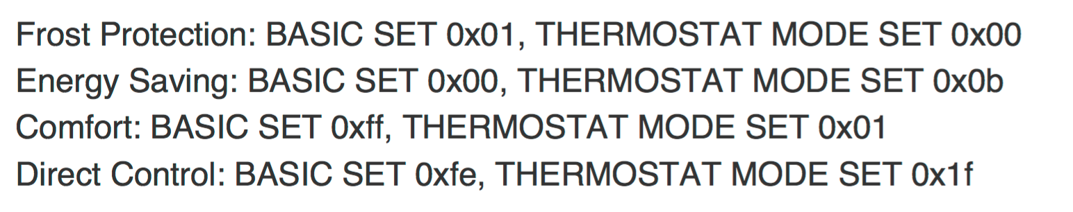

I need to change the operation mode to Direct control. The class commands are:
Direct Control: BASIC SET 0xfe THERMOSTAT MODE SET 0x1f
But I have no ide how to send it to the device.
Please help me out.
Skärmavbild 201...
Zipato uses the same modes: off, heat, cool and auto as they use in their virtual thermostat with stella. You can use the device browser or rules to control stella directly (set_temperature and valve position).
