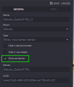

Albin,
Qubino module's input need to be manualy configured to be "shown as a device" and therefore appear on rule creator. On your group 5 settings look for the Binary Input end point, hit configuration, check on "show as device", save, sync and refresh the web browser.
See attached.
Albin,
See attached.

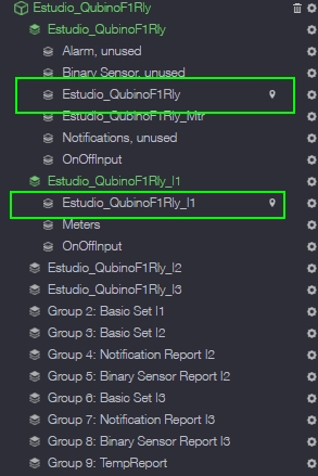

In your configuration window for root device you have "enable/disable input 2" check this. This might likely need to be changed. Read the manual. After this is changed to allow input, the device will need to be excluded and reincluded in zipato.
Then you should have input 2 listed (as I have)
Look above in the picture. It says default value is 0. So perhaps you had it included with 0 and zipato saved then as 9 due to their descriptor setup. Query the parameter and if you receive 9 i advise you to exclude and reinclude the device (do not reset). It should work. But you must do it before continue troubleshooting.
I forgot about that setting for Qubinos, as Attila describes, you should be able to see the endpoint correctly after you change its configuration and exclude/include again. If you read the right configuration from the device, and exclude/include and you still have the issue I would recommend you to open a ticket on zipato support. I don't have qubino dimmers (only flush relays and shutters) and I never had issues to see their inputs as bynary sensors.
