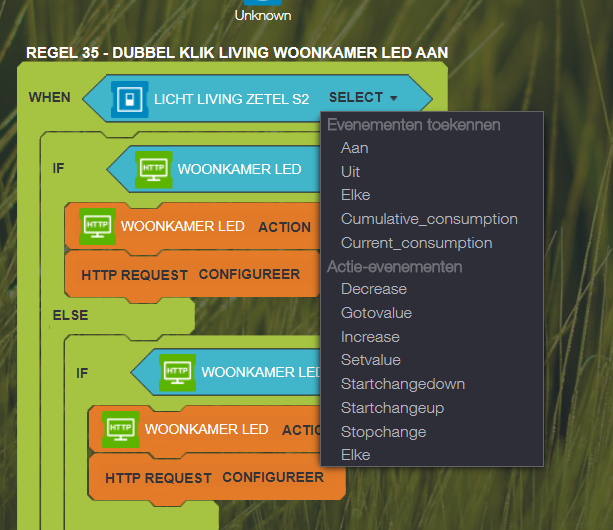

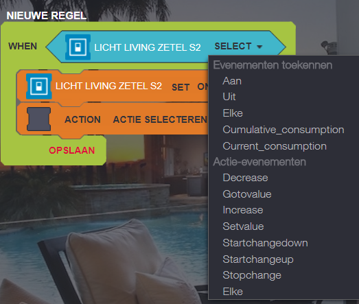

It seems that on the FGS223 Double Switch i don't have the pressed 2 times , pressed 3 times and hold in the controlleron the rule creator

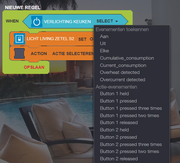

I have also single switches and there i can shoose the pressed 2 times and 3 times ?
Settings ? can't figure it out.

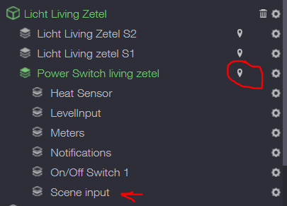

if found the solution , in your module manager go to your z-wave device .
And see where your scene inputs are, are shown, click on the wheel and active "show as device"
then you will see the device under controller in the rule maker. thx

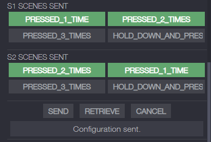

Fibaro FGS223 has in configuration parameters 4 options and all of them can be activated in order to enable scene sent events in the rule creator. To change activated options, please click on its buttons and press Send command to update configuration parameters in the fibaro device (please wait to receive confirmation message about updated parameters from the device).
After that using of scenes IDs will be possible in the rule creator.

i tried that but nothing showing up in the rule creator under controller.
