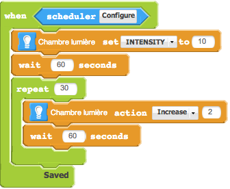

I'd like to set up a rule to create a "luminosity wake-up function".
If I need to wakeup on 7am, I'd like to set my bedroom's light to 10% (intensity) at 6.30am, then increase it by 2% every minute so it would be at 70% at 7am when my wakeup alarm will ring.
I tried to use the "repeat" control (not the one in scheduler) this way (see attached file) but it doesn't work...the rule sets my light on 10%, waits 60 seconds, then increase it by 2% and then everything stops.
Could anybody explain me how to use the "repeat" control correctly please?

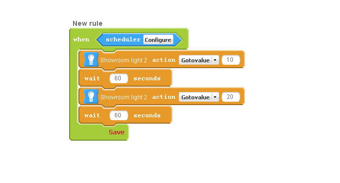

We have a bug with repeat puzzle which we are trying to resolve ASAP. For desired effect please try following ( use example in attached picture for starting point).

I was thinking about your way to do it, but I would need to set 30 actions and 30 pauses as I want to increase light by 2% each minute ^^

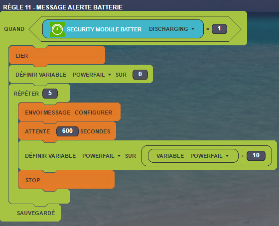

Hello everybody,
May I suggest a solution ? Maybe you can add a block "linked" to your rule.

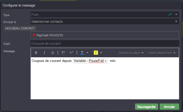

I had the same problem with this repeat function. My need was to receive a push message each 10 minutes when the battery of my security module was charging (it means that I have a power failure at home).
It seems that although the limit of number of repetition, the rule is executed each time the condition is verified within the 600 seconds. This afternoon I received 50 push messages i/o the 5 requested with this own rule without refreshing any status...
The rule attached is working fine
