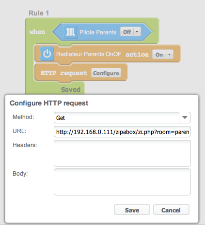

Does the HTTP requests (from the rule creator) are sent from Zipato servers or from the Zipabox ?
In fact, I like to send HTTP commands to my Raspberry pi located on my private lan (192.168.x.x).
Is it possible ? (without passing by internet).

I have http request in my rules and they are received by my rip to log stuff in mysql base and it works. I'm not using it anymore but a few weeks ago it was still working !
Yesterday it did not work.
But I have to say may be I made a mistake on URL configuration....
I have made a network sniffing and did not view any traffic addressed from Zbox to R.Pi. After Sebastian comment I stop debugging.
Sebastian, can you clarify please because on my zipato request are sent from my box and not the cloud.

Yes you can use local IPs in "HTTP request" puzzle, just make sure IP is reachable form the network on which is Zipato connected.
We don't support incoming HTTP requests yet (from local network), but it will be implemented soon.

My fault, I was just wrong on my HTTP request.
It works now through my private LAN.
