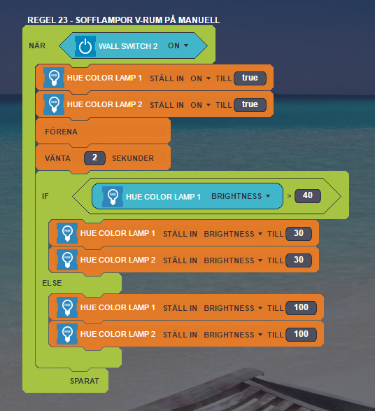

I control 3 x RGB and 2 x White Hue bulbs already with rules. I run FW 1.0.17. Maybe you need to first toggle ON and then set brightness/color. I do this in my rules. See attached
Files: Hue.png
