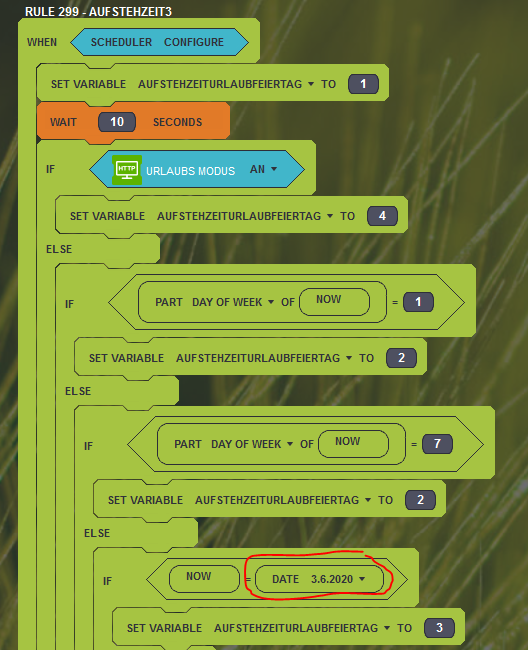

Maybe someone has a solution. I try set a variable regarding a specific date, but it doesn't work. What is wrong (red circle)?

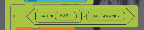

Now is a date/time field. So comparing Now with a date does not work. Try: Date of Now = Date 3.6.2020
It works, many thanks! :-)
