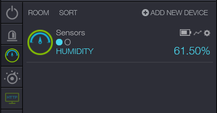

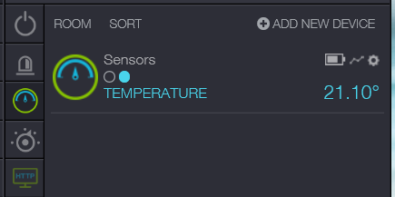

Hi Kristoffer,
What is weird is that you can get values from devices view. So, the device is correctly supported. In device manager, in the tree of this device, maybe you should have a look at the checkboxes "show as device", "hide in rules creator", "hide in device browser"... There may be a mis-configuration...

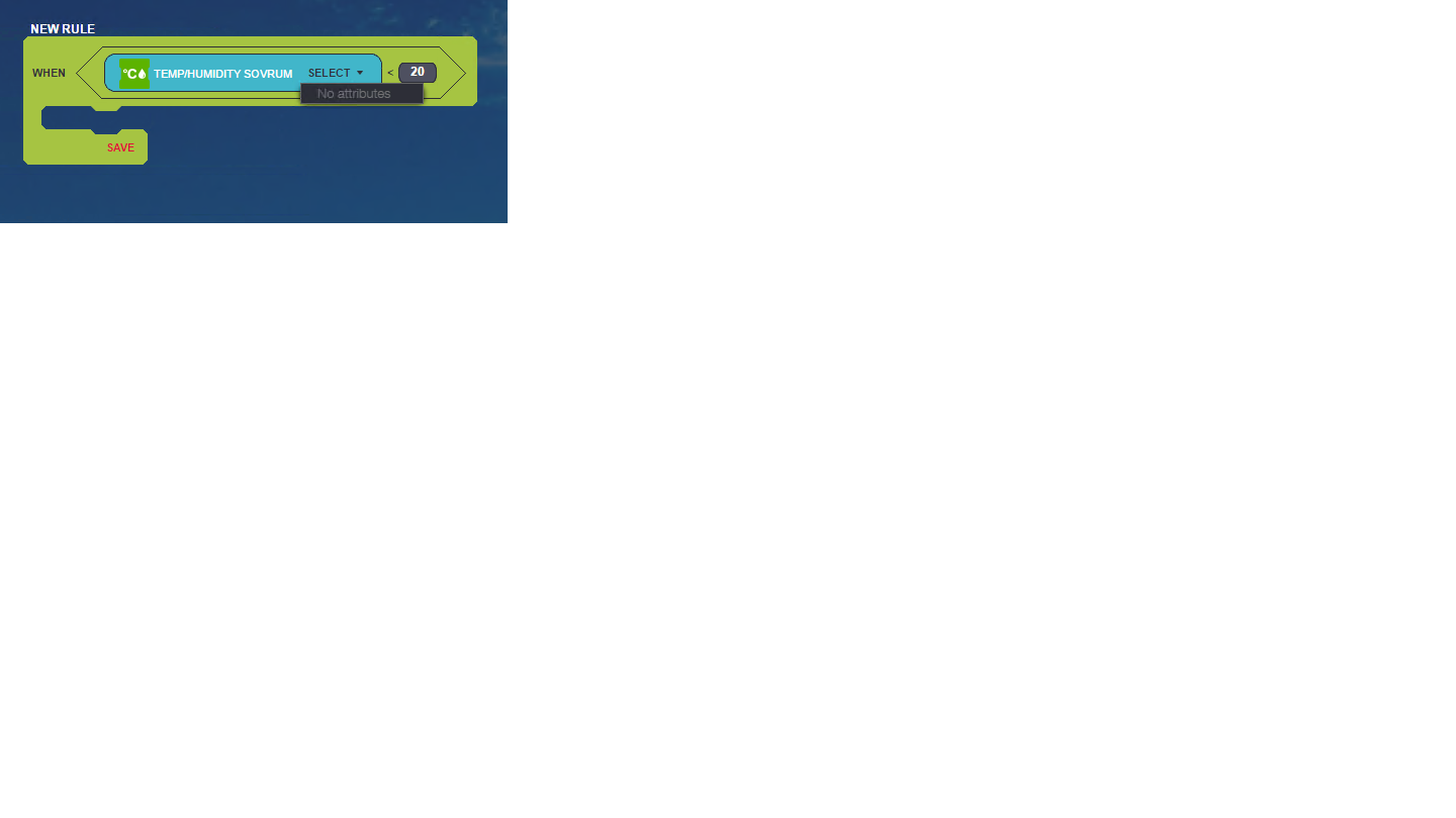

Hi Robin,
I checked again and the device is tagged with "Show as device" and the "Hide in rule creator" and "Hide in device browser" aren't checked.
I can choose the device and put it in a sensor field in a rule, but when I choose the dropdown to select which attribute to use it only shows "no attributes".
I have a Aeon Labs Multi Sensor 6 as well and the configuration between the two are "the same" in terms of visibility etc.
I've attached it as a picture here to illustrate as well

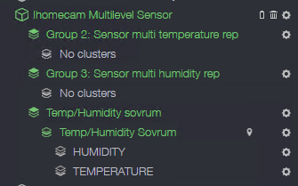

Kristoffer,
Could you post a print screen of the tree of the device with all leafs expanded in the device manager please?
Kristoffer,
Of course Robin, attached to this comment :)
So, you clearly have Temperature and Humidity Attributes attached to the device. Seems that it is a Zipato support issue.
Open a ticket on zipato support, joining your zipabox/Zipatile S/N and they should be able to help you.
