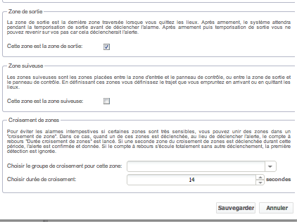

So now, I'd like to avoid that kind of errors (even if it is really rare) by using the zone crossing possibility of the security widget.
I activated this functionality in the main alarm options, and put 2 sensors (zone 2 and zone 3) in the same Group.But when I close the settings window and synchronize, it doesn't save the group I have put the sensors into (zone 2 and zone 3)Could you please explain me how to use this functionality?
Actually I am not able to arm/disarm the alarm (it always days not ready for one of my sensor even if this one is not triggered). Any news about this?
