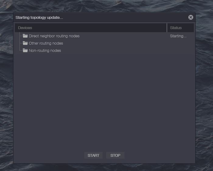

Yesterday my devices suddenly stopped communicating with the box. I have tried a reboot, reset, a network-heal and a hard-reset. The healing process and the hard-reset don't do anything, this processes just hang... (see pictures)

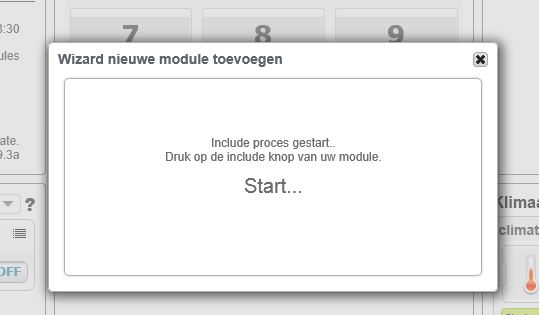

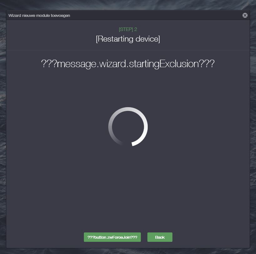

In the old interface, the counter doesn't start, it just hangs with 'start' (see picture). In the new UI i see strange unreadable texts (see picture) and this also hangs...

it seems like your Z-wave radio module has stuck. Please try to unplug your box from power supply completely, as well as from backup module (if you have it). After a minute, plug the power again, and try to join some devices.
btw. after you did hard-reset, you got the old firmware version which doesn't support network healing and some other options which you are mentioning. In order to use all options, you need to make sure you are always using the latest firmware version.
