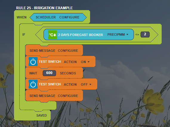

this looks fine, i am not familiar with the oregon sensors and their outputs, but the rule looks fine. I have used a similar rule but with the virtual weatherstation. This checks the weather forecast for the next 2 days, and if there will be less than 2mm of rain, turn on the sprinklers.

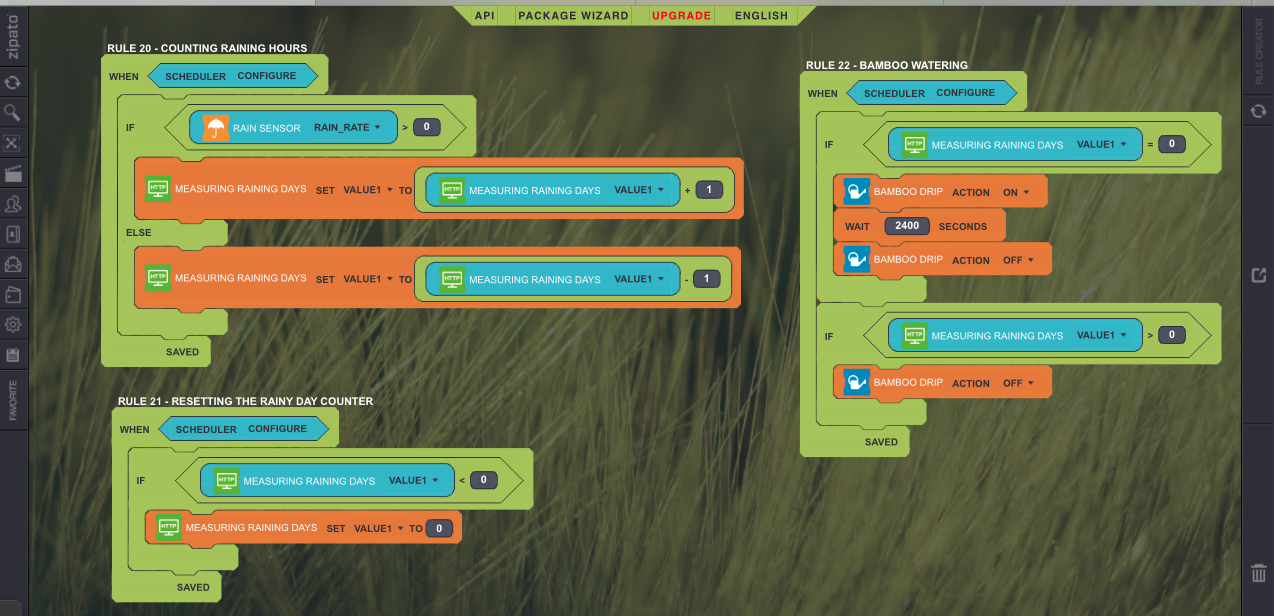

Following your advice, I have programmed three rules.
First rule is triggered every hour and checks if there is currently rain (rain rate >0). If so, it increases a value for 'rainy days' by +1. If not it decreases the value by -1.
Second rule triggers every hour and resets the 'rainy day' counter to 0 if there are too many 'dry days', which would mean that counter drops too far below zero.
Third rule is checked every 24 hours (the actual irrigation) and switches on the irrigation if the 'rainy day' counter is zero. It does not switch it on when the counter is > 0.
The rule would imply that for each hour of rain, the system waits the same time before it switches on the irrigation.
Hope this works. Any feedback is welcome.
Frank,
in your first rule (counting raining hours) you have RAIN SENSOR.
is this RAIN SENSOR virtual device or something else ????
