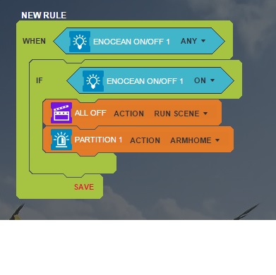

do you mean something like this. All on and all off (and what ever other scenes you create are in the scenes list on the bottom of the devices tab.
Yes but in the other way around. I have a remote control that I use as a secondary controller. I can initiate all_in and all-off actions from the remote. I would like to intercept the all_in or all_out actions when I press the button and not only to limit the action to devices where this function is included by design.
