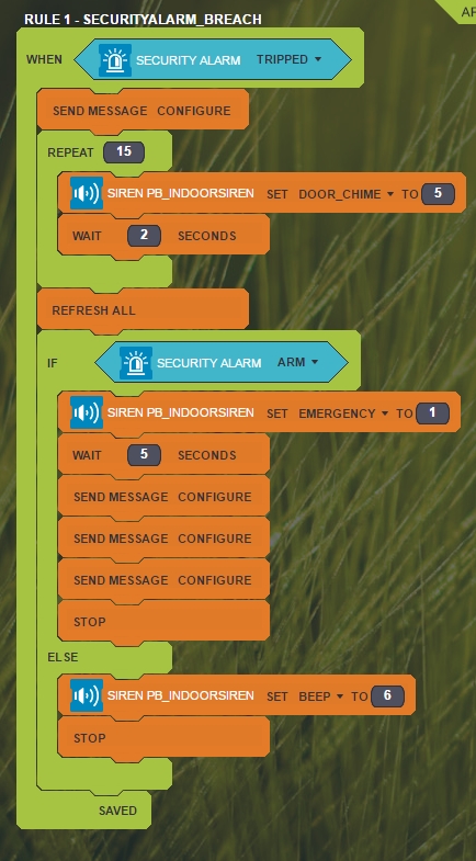

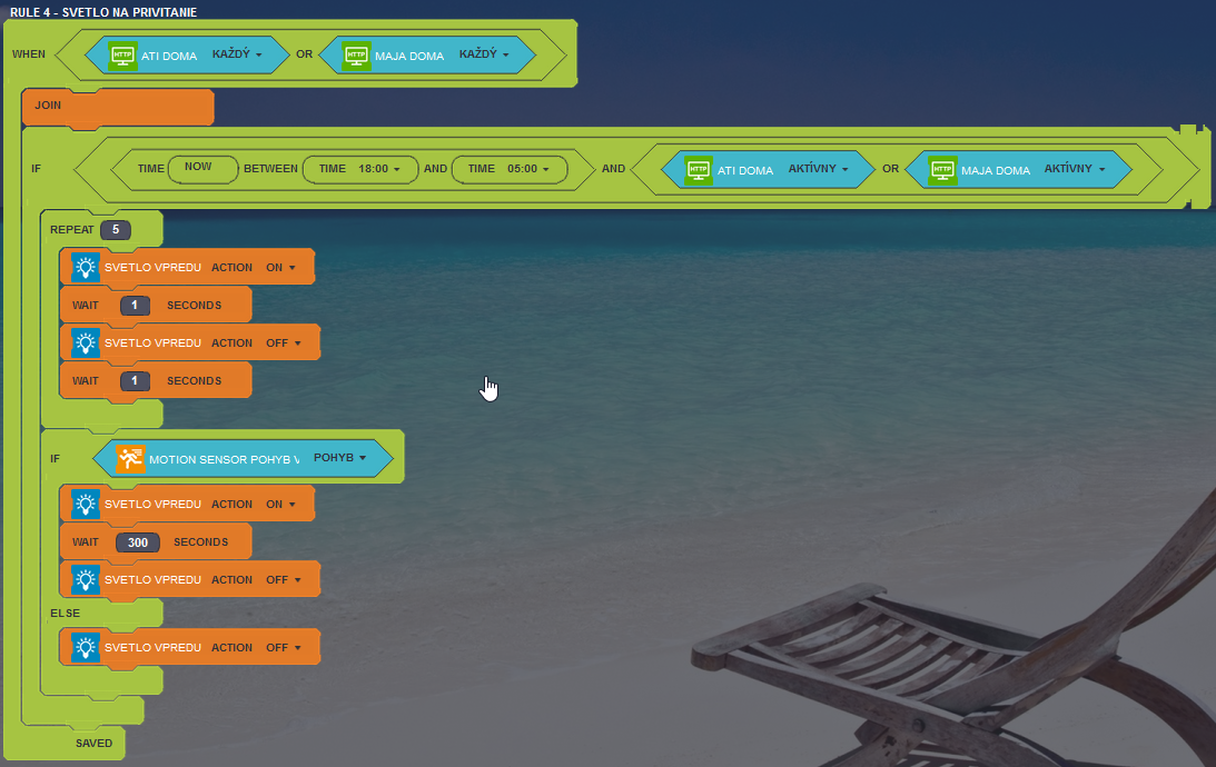

I have the attached rule which uses a repeat puzzle working properly, never tried to add another puzzle inside REPEAT though.

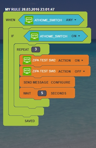

I'm pretty sure it's a problem from zipato, I was using without problems the repeat puzzle before upgrading to 0.9.999.8q mine is not working anymore, I did another test, see attached, without luck. I tried it without the repeat puzzle and it worked. I would recomend you to open a ticket in zipato support, I already did.

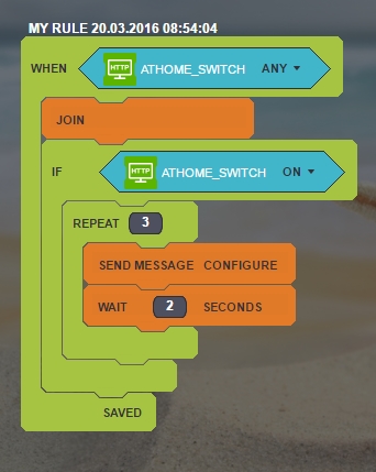

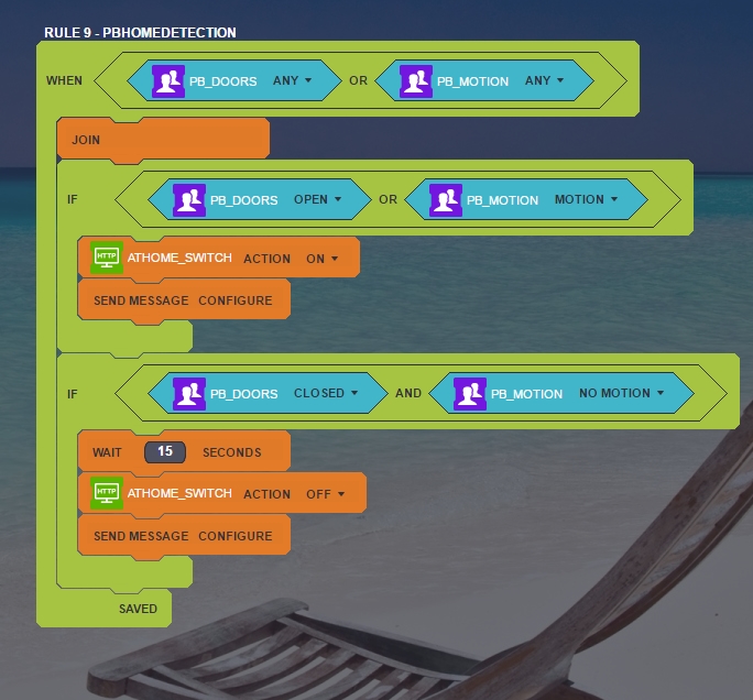

Ok so I found the problem, it is not the repeat or message puzzle. I is the fact that the virtual switch I was using is part of another rule which is triggered by some sensor groups (which doesn't work, I have an open ticket for that), and the fact that the rule was enabled. I disabled the rule with the problem, replaced the first switch you have created and then modify the rule as attached. Both repeat and message puzzle works.First image is the rule that is causing the issue with "At Home" Switch, which I disabled until fix is found. Second rule works.

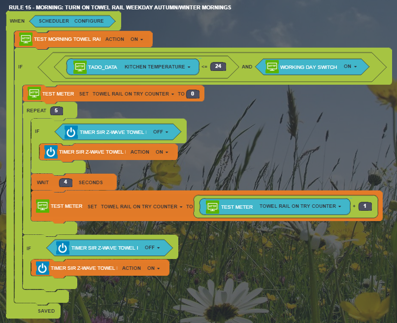

I have a rule that turns on a towel rail in the morning. It works some days, but not others, according to no discernable pattern. So I tried using a repeat loop to turn it on, to test whether the rule was somehow running, but failing to operate the device sometimes.
The loop runs five times. It queries the towel rail to see if it's on, and if not, turns it on. It then increments a counter to track the number of executions of the loop. The counter is always augmented, unconditionally. So the counter should always reach 5. However what I see is that on one day the counter initialised to 0, and was then incremented to 1, but no more. So somehow the loop, or the whole rule, aborted after running once. On the next day, the counter initialised but nothing more, indicating the loop completely failed to execute.
After the loop, I placed YET ANOTHER attempt to turn on the towel rail, in case the loop failed. But that didn't help. On the first day, the towel rail came on (because the rule made it once through the loop). On the second day, it didn't.
This suggests to me that the rule is "crashing", or aborting, for some reason. Whatever comes afterwards in the rule simply doesn't execute.
Dave,
Can you post your rule?
Sure. Here you go. It's a bit messy but it's basically a desperate attempt to get the thing to work reliably - without success. Stripped to its essentials, it's 2 lines!

Ok. I can confirm that it solved my problem (removing a Join puzzle in case the rule had repeat puzzle).
