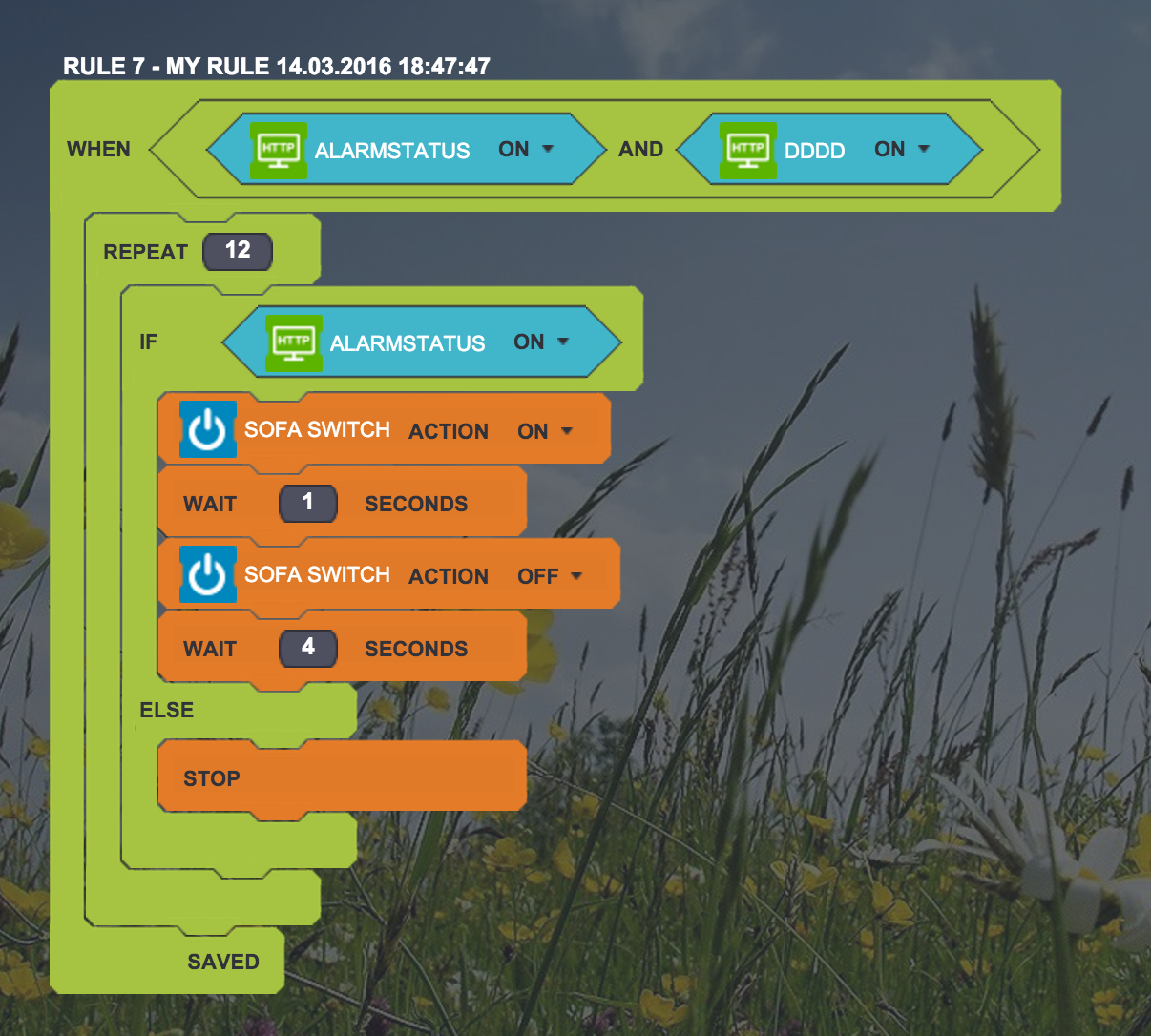

Complex rule, seems not to work (Armed alarm and opening a port)
I am testing it with the door sensor but also replaced it with a virtual switch..
The repeat sequence starts, but when I disable the alarm (so the virtual switch goes off) the second if is not working..
Any thoughts?

Use ANY at the first line.

any?
refresh all did the trick

I think your rule is fine with the refreshall.

The rule is only triggert when it is ON...so the else is not triggert.
That's why you need the ANY (ON or OFF).
