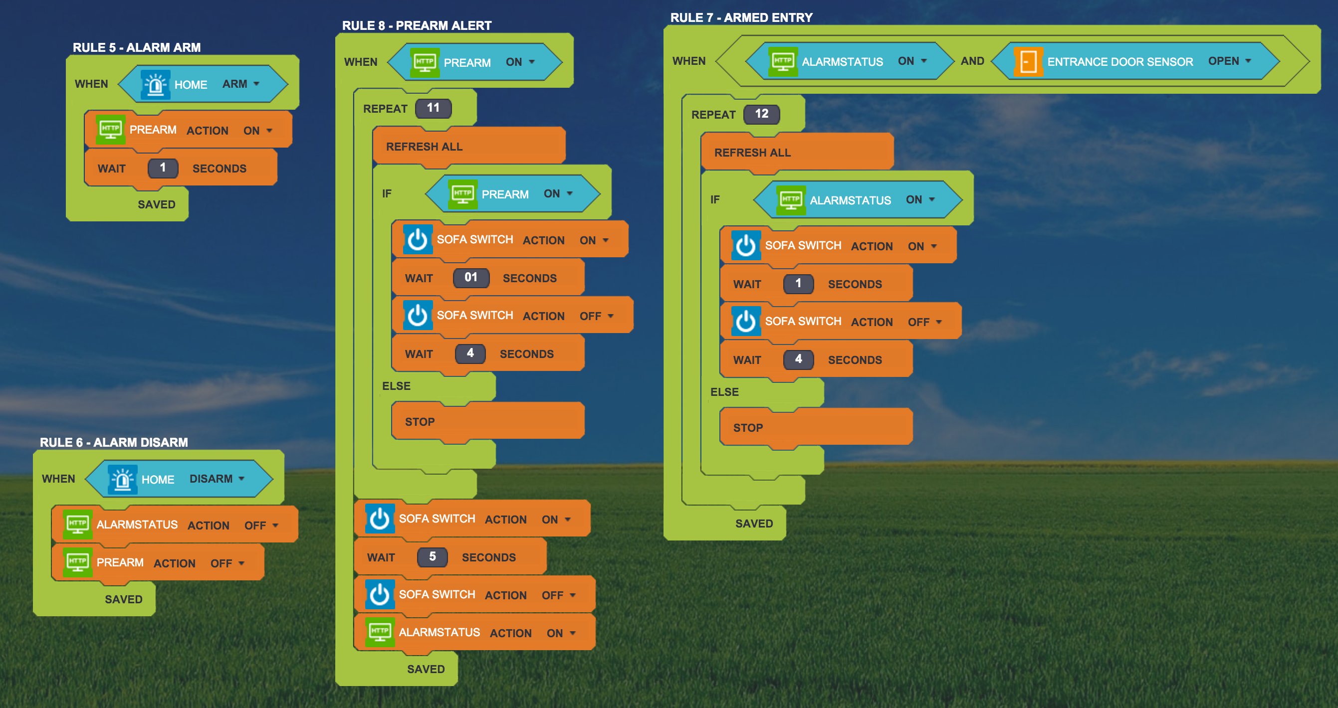

My complex rule for Alarm Arm/Disarm and Entry
I have thought about it, this is the closed I can compared to a real alarm system.
now I am looking for a device to be the "beeper" for the entry, any suggestions for a cheap solution?

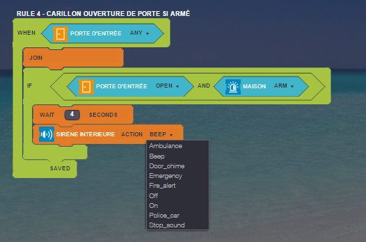

Thanks for sharing, I will look into using this in my rules. As a beeper, I use the zipato indoor siren which has 6 rings, including a door chime, beep, etc....

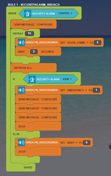

I had the same issue and solved with this.... I'm using a Zipato Indoor Siren.
https://community.zipato.com/topic/zipato-security-system-improvements
