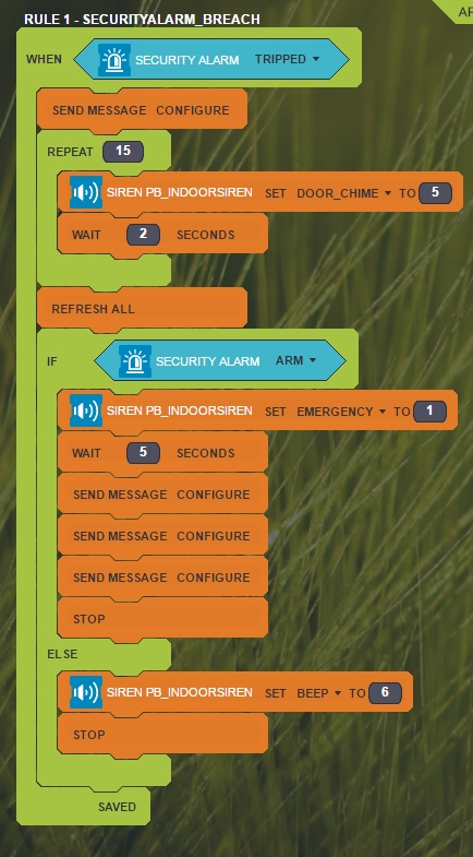

3. Entry/Exit Warning Sounds – Most security systems can be
configured to give you an audible warning (beeps) while the Entry/Exit time
period is passing by. I wanted my system to give me a warning (beeps) while the
entry time is passing by and then, if not disarmed, to sound the siren with the
emergency sound, this cannot be done using the alarm configuration. If you
configure the entry or exit delay, siren is silent (off), and there is no way
you can use a rule to trigger the “Beeps” in the siren since the alarm system
is still not tripped, until this time is expired. If you remove the entry/exit
delay, then the siren sounds the “last used sound” for the configured time
immediately.
It would be very nice if we could configure a sound for
entry/exit delays, such as beeps, to be sound while the entry/exit delay
configuration expires and also to configure and emergency sound if security
system is tripped, different sound for fire/smoke detection, etc… That way no
rule like the one attached is required, only configuration.

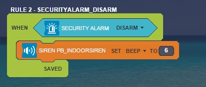

About point 3: Workaround: A rule when door opens/motion sensor senses motion and when alarm is armed can be configured to take actions ahead of the tripped event. Less practical as this must be done for all sensors used as alarm zones. I think this is where grouping sensors could make things easier, but I have read this feature is not working well so I haven't yet tried. I use this to beep my zipato indoor siren to remind me that the alarm is armed when I open front door.
About point 4: any rules base on when alarm armed will not be triggered when arming fails: I have a rule that beep my zipato indoor siren when it is armed: no sound = arming failed. I know I have to wait a few seconds and retry.
Olivier,
3&4. Yes, that was my workaround, I think this should be an integrated function though, see attached.
I am curious about rule 1, how does the 'tripped' event work? is it only triggered once on the first sensor that detects something, or it is trigered again and again when each sensor detects/redetects something (it could get messy: here a join would not do the job because the rule will be interrupted and restarted, a variable set at the start of the rule to register that the rule is in action and reset at the end could be used to avoid concurrent runs of the rule). PS: I think the 'stop' are not needed :)
Olivier,
The way it works is, my entry delays are set to 1 sec, so as soon as you breach any partition the security system will trip and start beeping for about 30 seconds and then sound the emergency (continuous) alarm. Since I'm not using a JOIN puzzle once the alarm system is tripped it will continue its execution. In theory yes, every "tripped" event will trigger the rule... I will test again and let you know.
Thanks for explanation and looking forward the outcome of your tests.

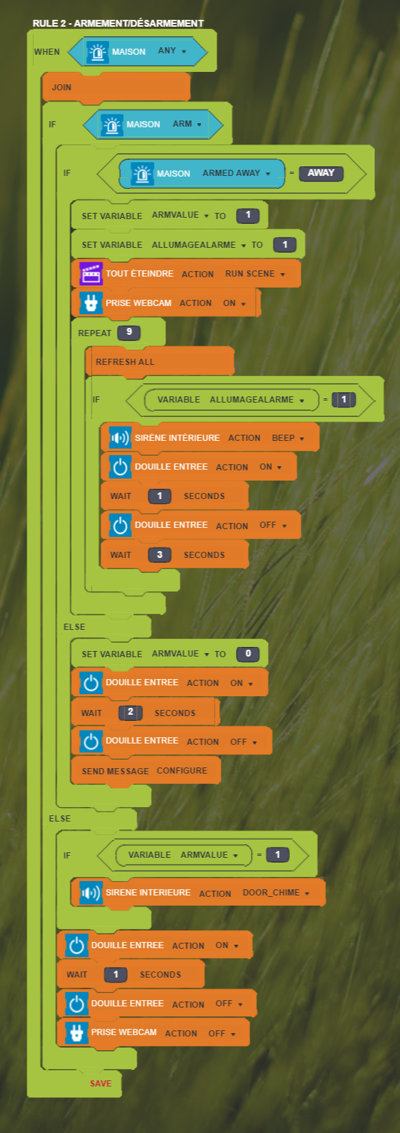

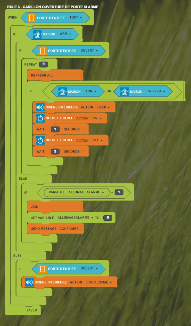

I would like in return share my set of rules that accomplish a similar purpose. Basically I start a beep/flash light countdown when I arm away the alarm until I close the door, and similarly I start a similar countdown when I open the door and the alarm is armed until disarmed.
I use two variables :
  • one 'AllumageAlarme' (I'm french, it means 'ArmingStatus') that is set to '1' when I start the arming procedure and reset to '0' when I want it to stop (on closing front door)
  • one 'Armvalue' that registers if I am arming away ('1') or arming home ('0'), so the procedure is different (usually kids are sleeping when I arm home)
Thanks for sharing Olivier. I will post my final rules once I do all the testing. I have been very busy latelly.
