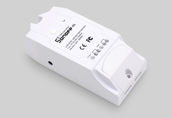

Is Zipatile compatible with Sonoff devices? Like shown on the attached photo
David shared this question 7 years ago
Thanks!

Hi, Zipatile is not compatible with Sonoff device.
List of supported protocols you can find under https://www.zipato.com/how-it-works/compatibility

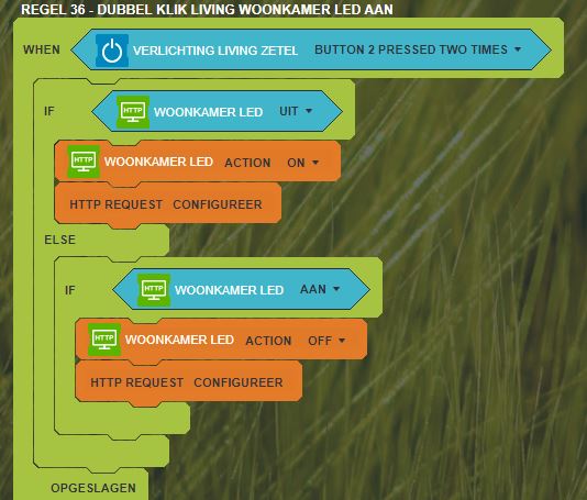

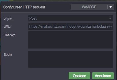

no integeration, but you can link it via ifttt.
Setup the sonoff via ewlink.
then create new applet in iftt, choose webhooks, receive a http request and give it a name.
then add the an event from ewelink.
When created , go to services in ifttt and search for webhooks.
click on documentation , there you can create the https link. (fill in the name of your applet in events.
And use this link in zipato the turn on (or off) your sonoff device.
attached an example, in the http request you fill in the url from iftt.
