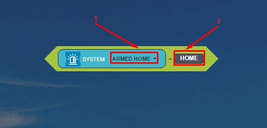

Dear All,
Our team has resolved this issue. Option to retrieve the exact arm status of the alarm is now available.
Please take a look at the attachment.
(1) Choose Armed Home and Armed Away
(2) It will automatically set up when you choose Armed Home or Armed Away in meter puzzle
Pero Zovkic
Dear All,
Pero Zovkic
Great ! I can see this (quite funny to use the alarm as a meter, not too intuitive but it somehow makes sense as well). Hopefully this will be documented.
Going to experiment now. Thanks a lot.
