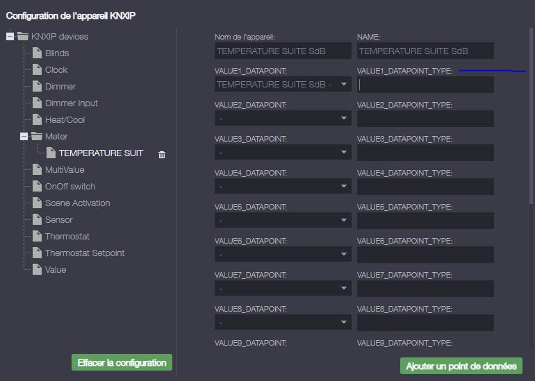

Another question, what do you have to specify in Value_Datapoint_Type? is it like "DPT 09" or 9.001 for temperature ?
Also, when I import my esf file, it has null for dptID and num... is it normal?
{"groupName":"TEMPERATURE SUITE SdB","group":"12/0/1","dptId":null,"num":null}
Thank you...
9.001, but it could be empty, because you will see only number and if you want degrees, you have to add it in api. It's OK, that is null null, it's another bug, I think.

Do you have correctly set KNX? You need to export project from ETS software and have KNX S-mode points. After that you will get esf file, and then you can use it in zipato. If you have temperature for example, you will choose meter in knx ip, choose correct item from esf file to value1 and synchronize. Then you have to wait, when the temperature sensor change temperature and send value through KNX network. It can take some time.

It's working!
In fact i was supposing that Zipato was polling the device... but it just read it from network.
So, when I was reading the datapoint from ETS, it was sending, Zipato was able to read it.
I've change the setup on the device to broadcast the value on the network, and it works now ! (of course, only Meter, not MultiValue or Value..)
