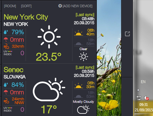

i have a problem... my virtual weather station does not sync. I don't get the newest infos. So my light doesn't start on sunset. The last sync was at 18.09 - 03:19

Mine was last synched 9/19/15 @ 22:31, so there appears to be a problem with the synchronization.

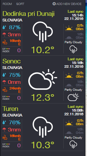

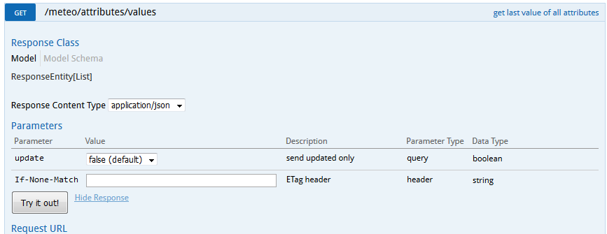

Well. I just discovered an interesting thing. Before I did this it was around 15:55. Every station (all 3 of them) that I have in the weather station section in the web ui did have last update around 08:XX (basically in the morning). I went to API / METEO /get
/meteo/attributes/values.
Without any change I just pressed Try out. The log loaded with a complete response.

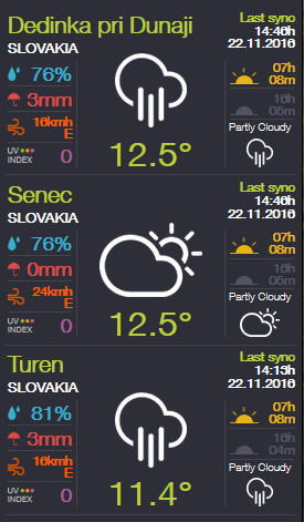

Now I have went back to the dashboard, the time was still morning, however when I did a browser refresh (pressed F5), voila, the weather station now showed the latest information from 14:46.
So overall it seems that the latest info should be possible to load, just need to send a query.

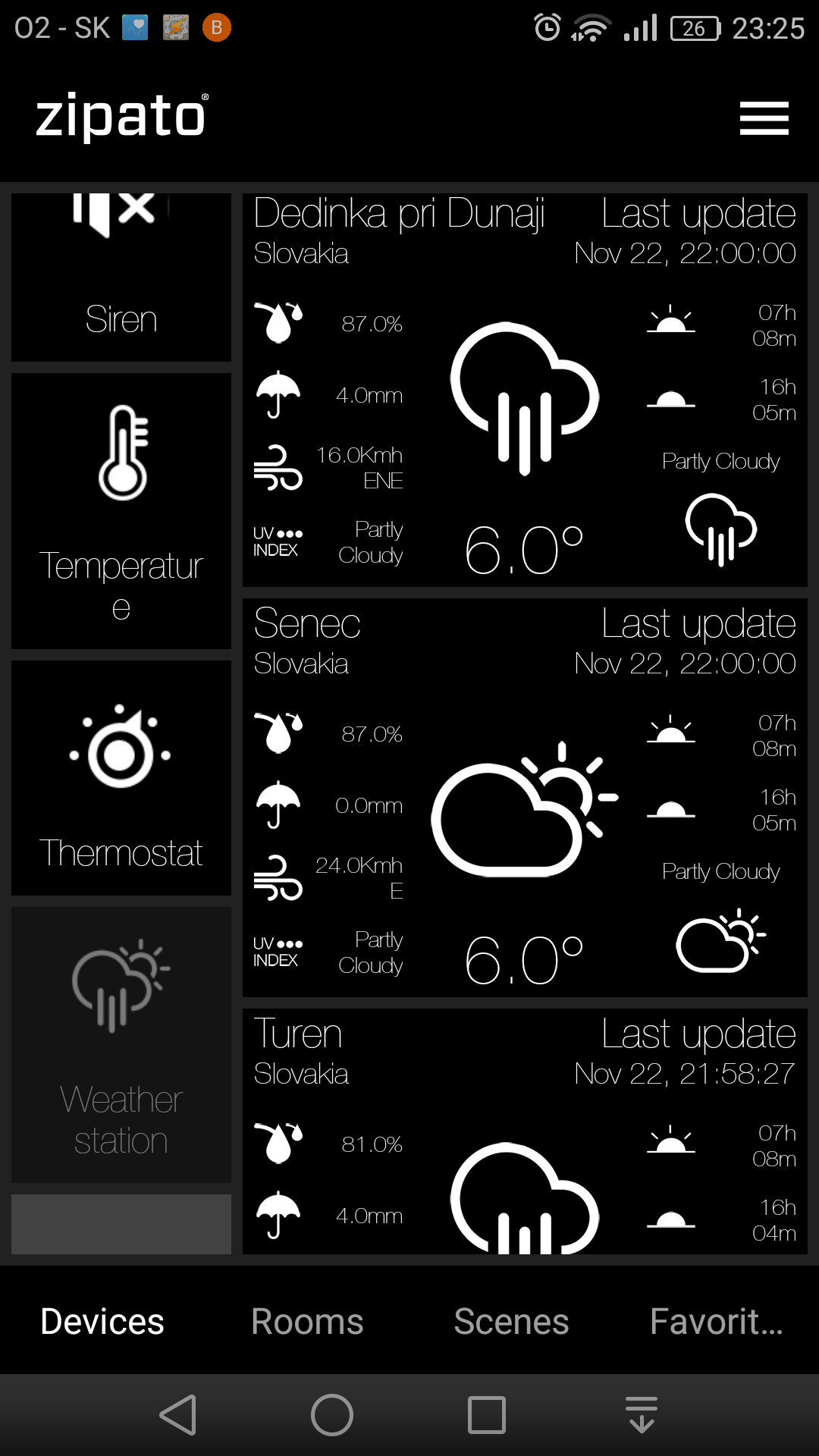

In the meantime I have done another test and now with pictures to prove that this is indeed possible to have latest details in the meteo station. See my pictures (before, after and the api call)
