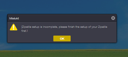

i did this but both my zipatiles now say setup not complete. And I can't do anything with them my zipabox works fine./D0XSKrJPVoHrAAAAAElFTkSuQmCCAA==
havent seen that before. Do you have just the 2 zipatiles in a cluster with a zipabox?
Which controller has your devices connected to it?
Is your Zipabox still in the cluster?
Have you rebooted your Zipatiles?
I encountered the exact same problem. I had to push configured=true via the API to make bring the Zipatile back to life.
zipato fixt it. on the zipatile there was a red bar which said contact zipato.
And standalone the HTTP request, virtual devices and rules work again on my zipatiles and box.
in cluster nothing workt anymore
