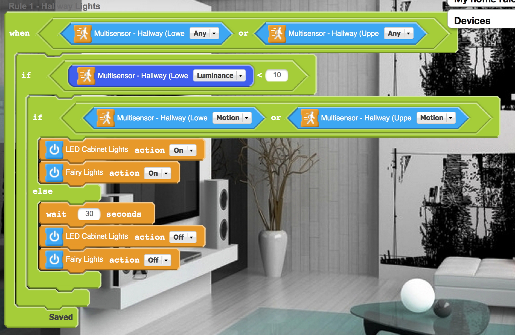

I'm new to Zipato and I'm trying to get the attached rule to work.
Basically all I want is for when its quite dark (using the downstairs aeon 4in1 sensor) and either the upstairs or downstairs sensors detect motion it activates two lights for a couple of minutes.
But it refuses to work...
What have I got wrong?
J
Tried again but still nothing :/

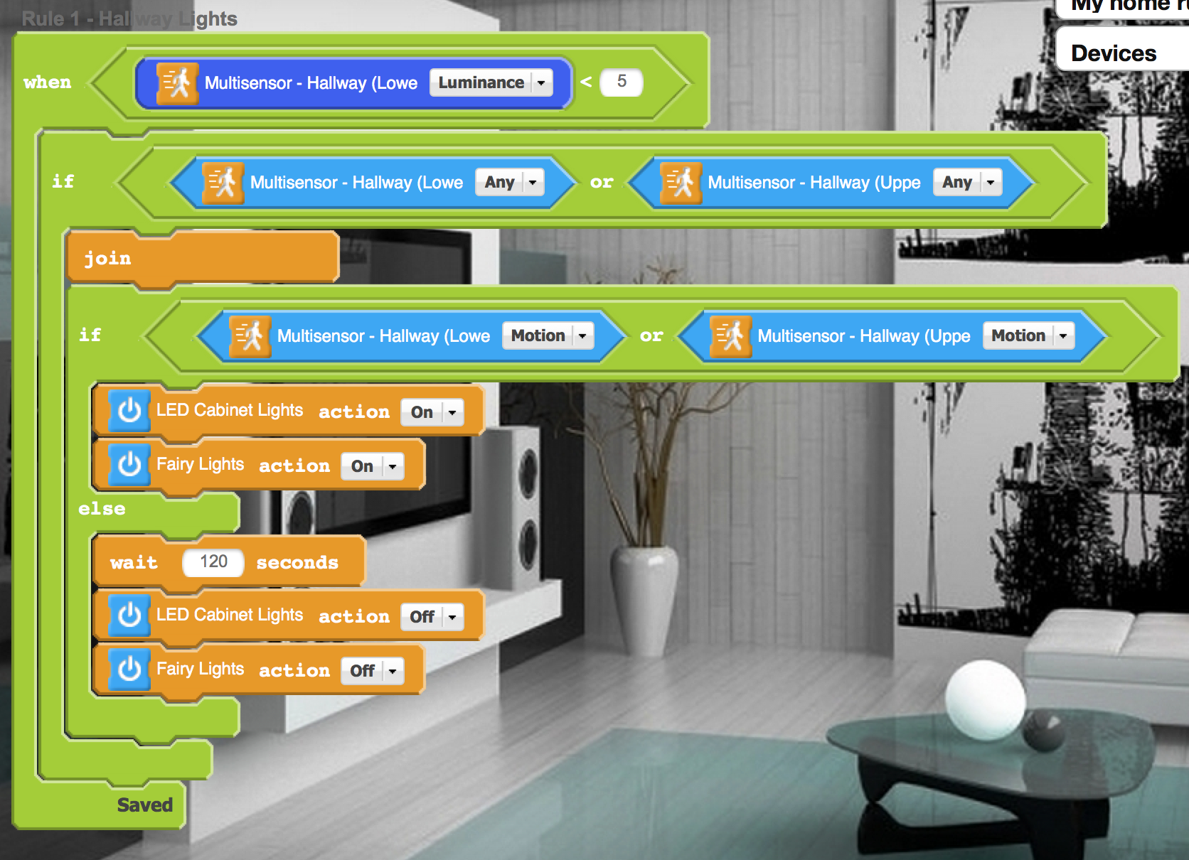

Try:
WHEN
motion x any or motion y any
IF
Lumin <5
If motion etc etc
And put some e-mails between the rules for testing.

Hey thanks for this!
This is what I ended up with (attached).
Do I need any join command in there? Say after the initial when command?
