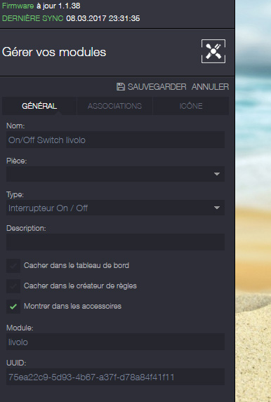

Not sure, does it show a UUID in device manager? Maybe delete and join again, they are sometimes a bit picky when joining.

can you show the link to this switch on aliexpress, and also a screenshot of the device in device manager?

It most likely uses a different protocol. The genuine Livolo switches don't show a tab called associations. See below how they look like.
